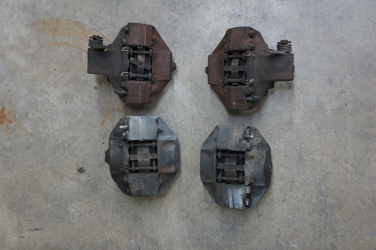

siverson
post Mar 7 2014, 10:18 PM
Posts: 2,464
Joined: 5-May 03
From: San Diego, CA
Member No.: 654
All four calipers removed and ready to be restored.
-Steve

siverson   All four calipers removed and ready to be restored...   Mar 7 2014, 10:18 PM
