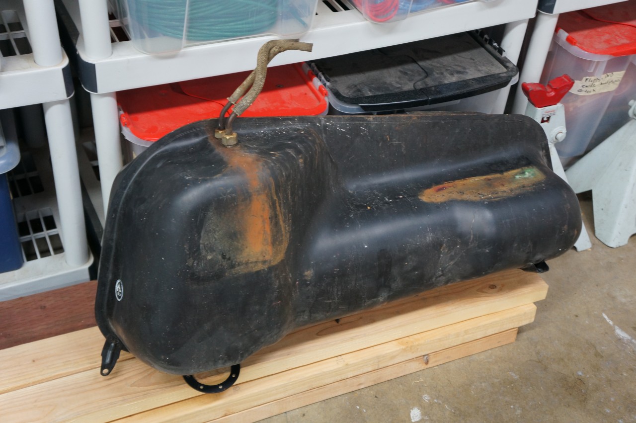

Nice... I'm pretty sure these are the original fuel lines. One also didn't have a hose clamp - on the car end of the hose. Is that right? Perhaps the return line didn't require a clamp? That doesn't seem right to me, but it looks like this gas tank had never been removed.
