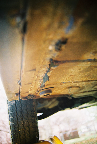

Here's a link to a couple hell hole pics. Not to bad compared to some I've seen. It is not rusted thru, just some surface rust.

QUOTE(Sfreeman615 @ Mar 10 2014, 12:17 PM) *
https://www.flickr.com/photos/119976543@N04/13067729523/
The battery tray and stand are interesting. (IMG:style_emoticons/default/biggrin.gif) I'd poke all that with a screw driver.
It's odd the the driver's side seems worse than the passenger side.
(IMG:http://www.914world.com/bbs2/uploads_offsite/farm4.staticflickr.com-11782-1394495955.1.jpg)
The car does have some east coast rust going on, definitely want to see what's under the rockers. No use making the outside pretty if it's about to break in half. -It doesn't seems that bad, though.

QUOTE(nathansnathan @ Mar 10 2014, 06:59 PM) *
Very good points here!! Gonna start stripping everything out tomorrow interior wise and do some poking around... Keeping my fingers crossed!
