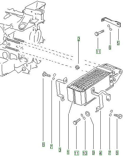

Has anybody here tried to replace your oil cooler seals with the engine installed in the vehicle (a la pelican article)? The article is a little vague and I think I loosened the wrong bolt and now I may have to drop the engine just to tighten it again! (IMG:style_emoticons/default/headbang.gif) I loosened a 17mm bolt next to the oil filter and now it just spins. I think there is a nut behind it that I can't get to. Does anybody have a picture indicating the correct bolts (or nuts) to remove?

If you loosened it, you should be able to tighten it again.
Maybe this picture will help. It doesn't show the nuts that you have to remove, but it clearly shows the three long studs coming from the engine block that the cooler attaches with.
