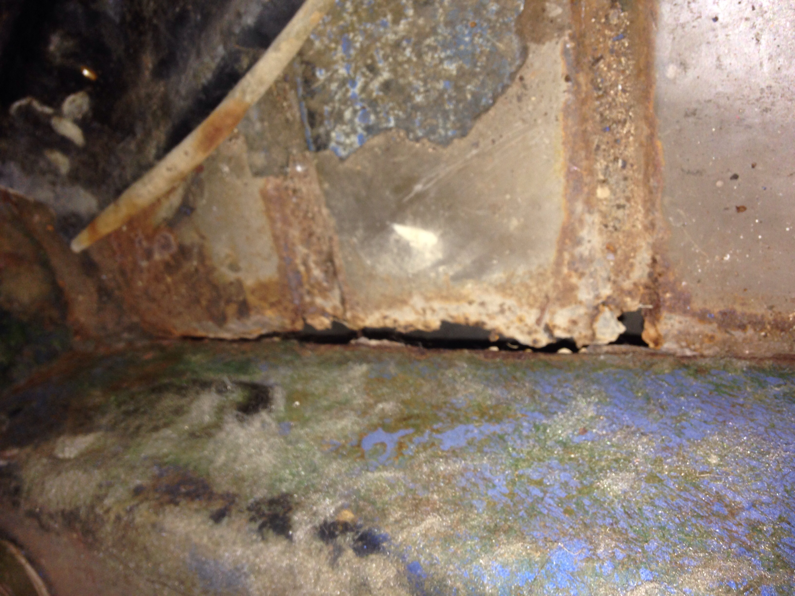

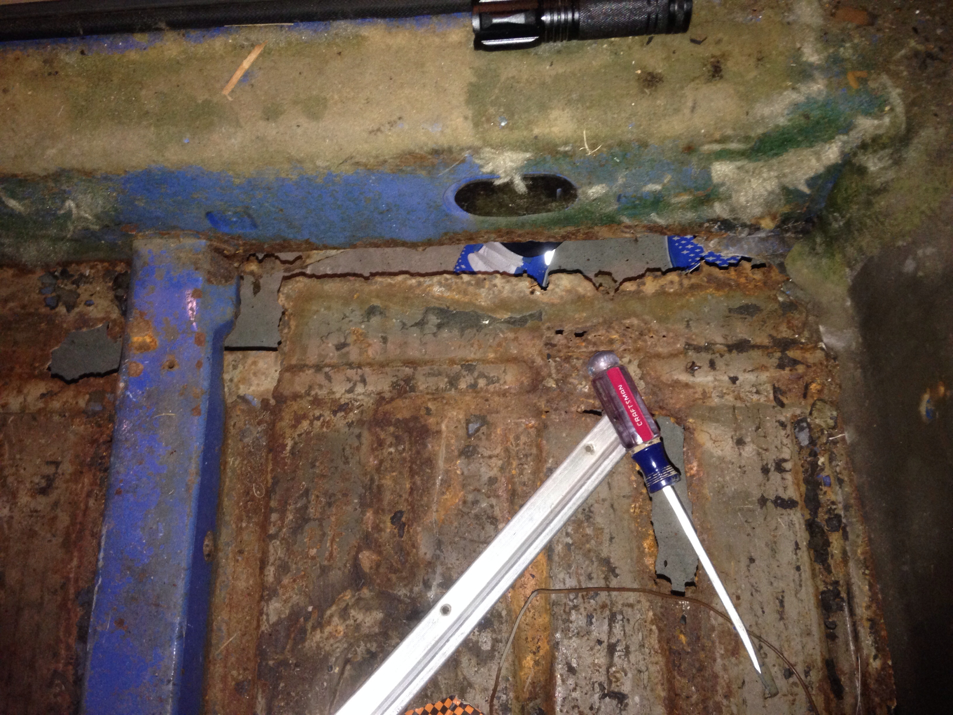

The worst is at the seam in the floor pan in the passenger side, done on the drivers side, I'm replacing them both! Anxious to see what the media blast will reveal!
