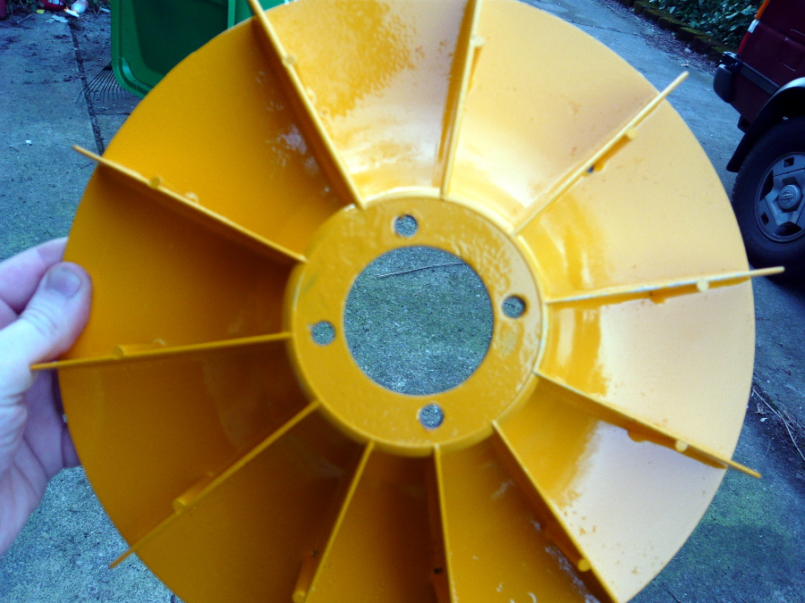

r3dplanet   So, I've been spending the past few weeks lear...   Mar 18 2014, 10:35 PM
r3dplanet   I stared at it for twenty minutes or so until it g...   Mar 18 2014, 10:46 PM
