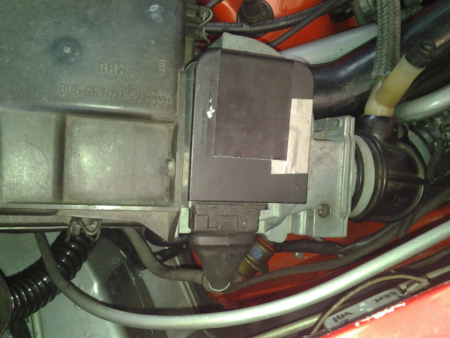

QUOTE(thatguywiththedatsun @ Mar 23 2014, 12:00 AM) *
Man, I'm stupid. Okay, after testing the correct pins, everything thus far checks out fine.
These guys are smart and they WILL figure this out for you. Let me throw in my 2 cents.
Admittedly, I have not read this entire post, so shoot me if this has been said or ruled out with your electrical checks. EDIT: post 14... (IMG:style_emoticons/default/bootyshake.gif) but I added a picture.
But I recently had the air filter box off of my L-Jet and forgot to plug the connector into the AFM... My car did the same thing. Started then died. (IMG:style_emoticons/default/confused24.gif)
the 2" wide connector on the bottom of this picture.
