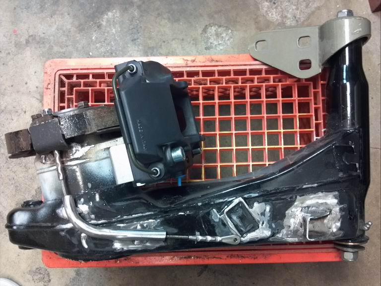

I'm quite certain this is covered elsewhere, but I've been racking my fingers trying to figure out what to search, and coming up dry.
I've got the Tangerine Racing 911 e-brake kit, and the instructions are almost worthless. Can someone tell me what I need to shave off of the 914 rear hub to get the 911 e-brake to fit? There's also a part I'm supposed to weld onto it, and I have no idea where that goes either. It also appears the holes don't quite line up. Do I have the wrong stuff? Pics below. I'm stuck. Attached thumbnail(s) |

Senior Member ![]() ![]() ![]() Group: Members Posts: 1,141 Joined: 3-May 07 From: LA/ CA Member No.: 7,712 |
The tube with cable is straight forward. I mounted mine so I barely had enough room to get the cable out of the backing plate if I ever had to replace the cable and swage a new end on. (probably wont but you never know???)
DO NOT follow my photos on where to locate the cable sheath stop bracket on the control arm. I am using a center pull handle so I am using two right side cables instead of the long/short system the car came with from the factory. Anyway I mounted the cables where they needed to be and relocated the bracket. Hope this helps. Attached image(s)

SirAndy If the holes don't lines up you got the wrong ... Mar 22 2014, 10:35 PM
sixnotfour yup , you have 74 or later..big bearing PB hats Mar 22 2014, 10:43 PM
CptTripps Well...shit.
So I need to locate everything, or j... Mar 22 2014, 10:48 PM
sixnotfour yup Mar 22 2014, 10:52 PM
