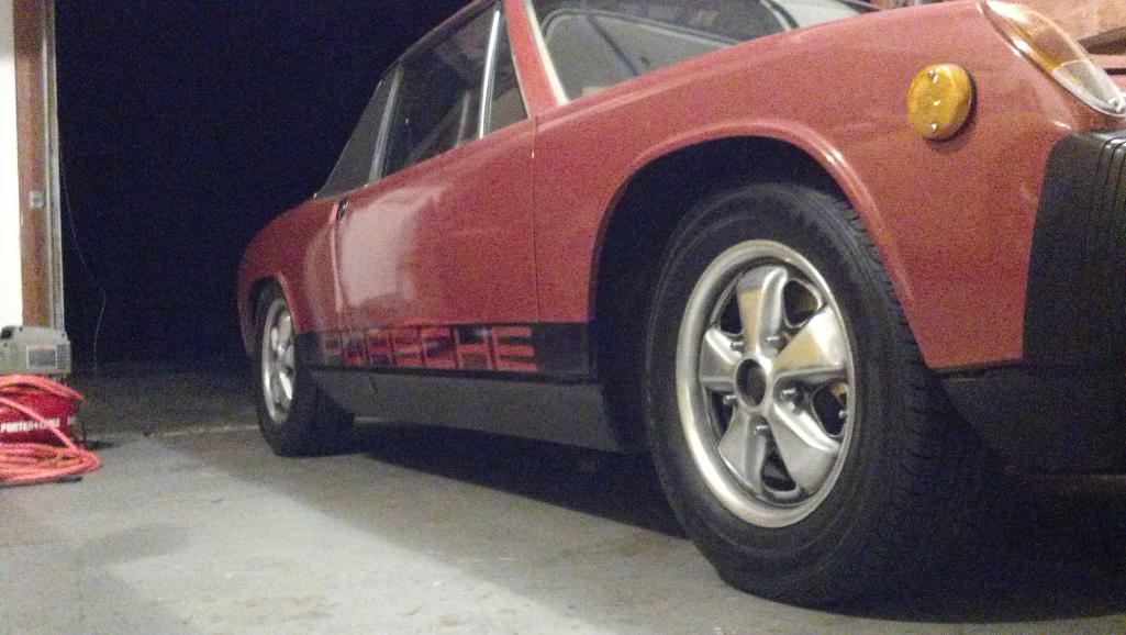

Finally took a picture. Pretty close to stock. When I do the new a-arms and tie rods I will look at dropping the front just a 1/2" maybe but for now I will leave it as is.

mittelmotor   Finally took a picture. Pretty close to stock. Wh...   Mar 24 2014, 10:06 AM
Chris H.   :agree: Looks fine as is but you can level it eas...   Mar 24 2014, 10:55 AM
Philip W.   :agree: Looks fine as is but you can level it ea...   Mar 24 2014, 11:15 AM
