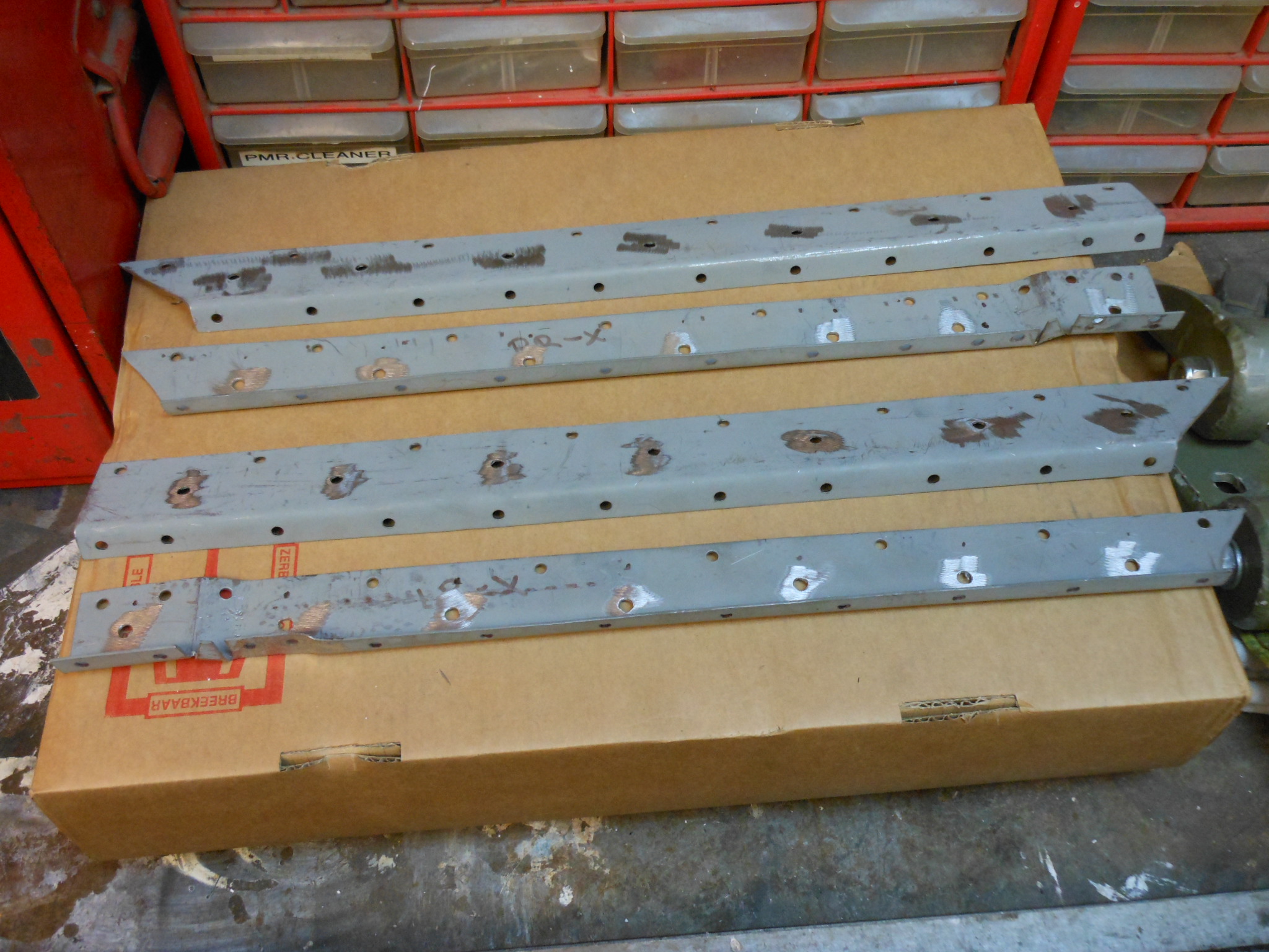

If the flanges are toast on the bottom of the crossmember and you have nothing to weld to make something up like these that go all the way across from long to tunnel and then across to the other long.

Great info.... I had no idea that the racers would actually remove those. I thought it was a critical structural piece. Once again ignorance is bliss I guess. I'm chucking the angle iron and getting the smaller stuff. Thanks again for all the great comments.
Dave |
