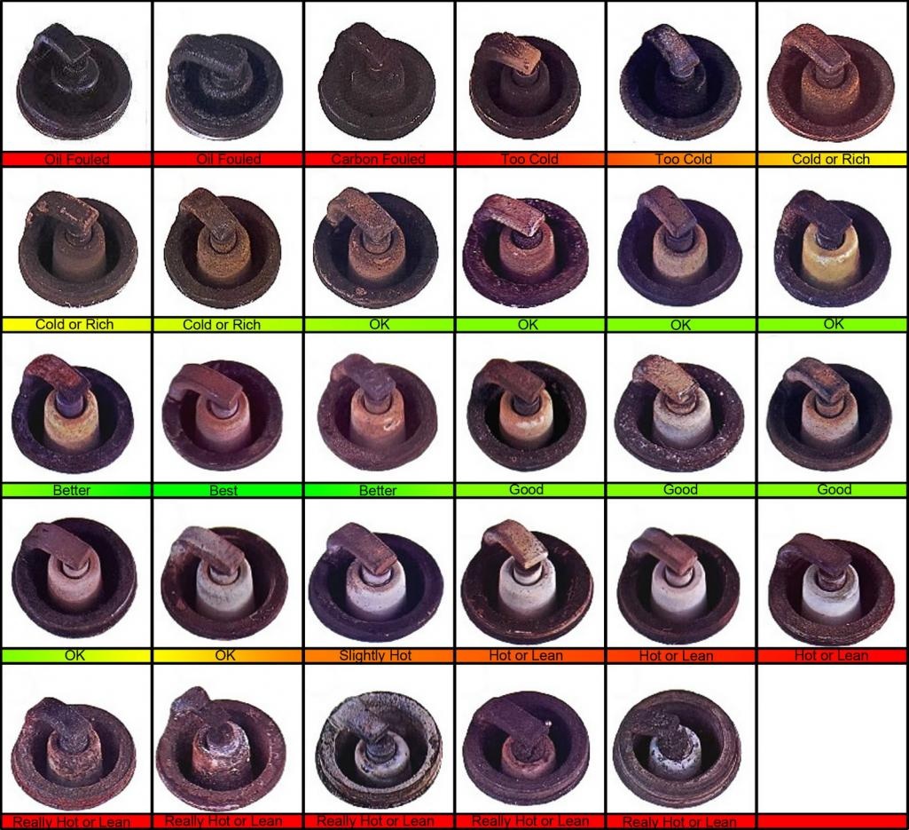

Not Hi-jacking but I found this to be really helpful in evaluating lean vs rich.
