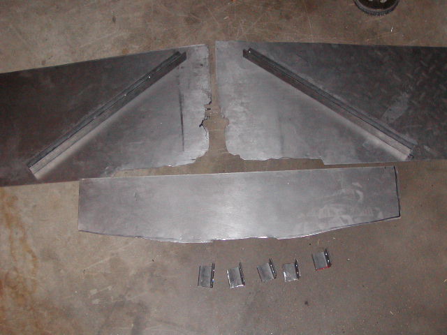

And I have been workin on the lousy radiator shrowd stuff... Ahh I just have to make up my mind about a few things.. do some final cuts, do some painting, put the radiator in, seal everything up good with some expando foam, and Im good for paint..

Andyrew   In the above pic, the top two pieces are for the s...   Aug 9 2004, 12:20 AM
Andyrew   And heres the hole... Not that big, but it should ...   Aug 9 2004, 12:23 AM

smrz914   Andyrew, I would have to vouch against the expand...   Aug 9 2004, 12:44 AM
Andyrew   Thats what I told dad.. but he insisted foam... We...   Aug 9 2004, 10:31 AM
