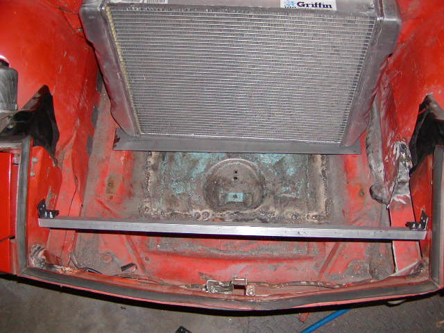

In the above pic, the top two pieces are for the side of the radiator, they have L brackets so the radiator is supported. and I have little L brackets to support the shrowds.
This pic has my poor excuse for welding the ac thing in.. Its lots of tack welds.. I'll use some sealer to seal it up after I por 15 it, then I'll paint. It also has the bar that will hold the radiator in place, I'll make a clamp that will bolt onto the bar, and will clamp to the radiator, holding it firmly in place.
