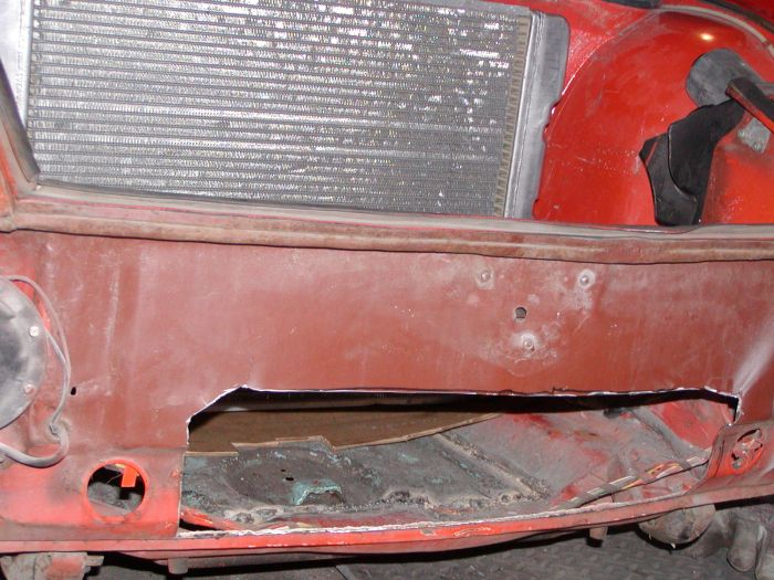

And heres the hole... Not that big, but it should work.

Andyrew   Oh I guess I could post some pics.. Dad rebuild t...   Aug 9 2004, 12:13 AM
Andyrew   In the above pic, the top two pieces are for the s...   Aug 9 2004, 12:20 AM
Andyrew   And heres the hole... Not that big, but it should ...   Aug 9 2004, 12:23 AM
Andyrew   And here's the 916 bumper that will have its h...   Aug 9 2004, 12:26 AM
smrz914   Andyrew, I would have to vouch against the expand...   Aug 9 2004, 12:44 AM
Andyrew   Thats what I told dad.. but he insisted foam... We...   Aug 9 2004, 10:31 AM
