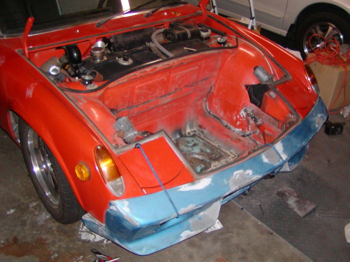

And here's the 916 bumper that will have its hole fiberglasses to the hole of the car, providing all the air that goes into the hole will go into the radiator and not through the air pocket between the bumper and the front nose of the car...
Yes I have to trim it a little.. It was made for flares. (I have (IMG:style_emoticons/default/smash.gif) flares...)

Andyrew   Oh I guess I could post some pics.. Dad rebuild t...   Aug 9 2004, 12:13 AM
Andyrew   In the above pic, the top two pieces are for the s...   Aug 9 2004, 12:20 AM
Andyrew   And heres the hole... Not that big, but it should ...   Aug 9 2004, 12:23 AM
Andyrew   And here's the 916 bumper that will have its h...   Aug 9 2004, 12:26 AM
smrz914   Andyrew, I would have to vouch against the expand...   Aug 9 2004, 12:44 AM
Andyrew   Thats what I told dad.. but he insisted foam... We...   Aug 9 2004, 10:31 AM
