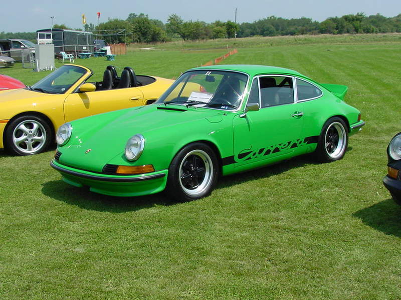

I have been a fan of the green on the 914 forever.
I think I want to go with the porsche viper green if I want a more classic solid color.
(IMG:http://www.914world.com/bbs2/uploads_offsite/forums.pelicanparts.com-10819-1396574083.1.jpg)
If I go with a more metallic, I will use chevy synergy green.:
[img][/img]
As for the 'prep for media blast in one weekend'... you are either a boss in the disassembly dept. or you arent planning on stripping the whole car!
I can drop an engine in about an hour, but stripping a tub bare would take me days.
Are you just blasting the exterior and keeping the interior intact?

QUOTE(stugray @ Apr 3 2014, 07:59 PM) *
[img][/img]
That is a GREAT color as well! I have been stripping the car for about a month now, pulling the engine, gas tank and AC this weekend and then it's ready to go to blast!
