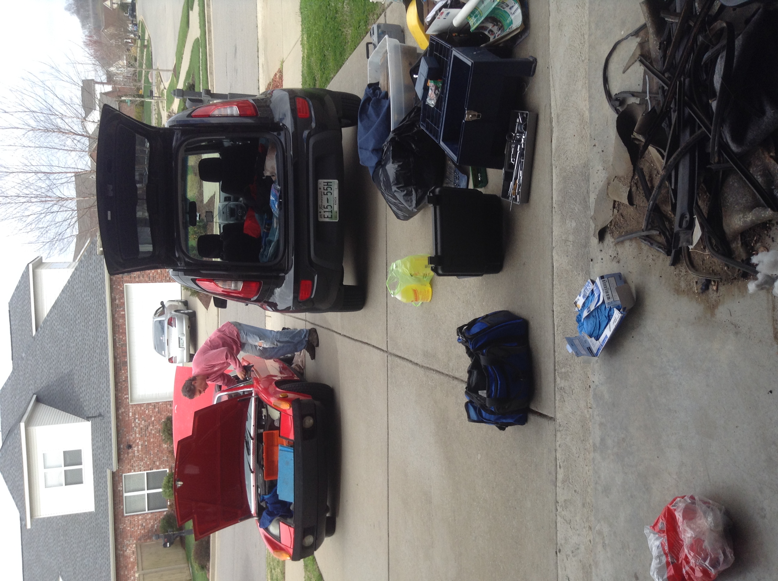

What an awesome day! With Mike and Clark's help (They did pretty much everything) we managed to get the car ready for media blasting and we pulled the motor! There's no way I could have done it without the help from awesome fellow TN 914World members! AS a nube at this I really learned a lot. Take a look at some pics from the day:
