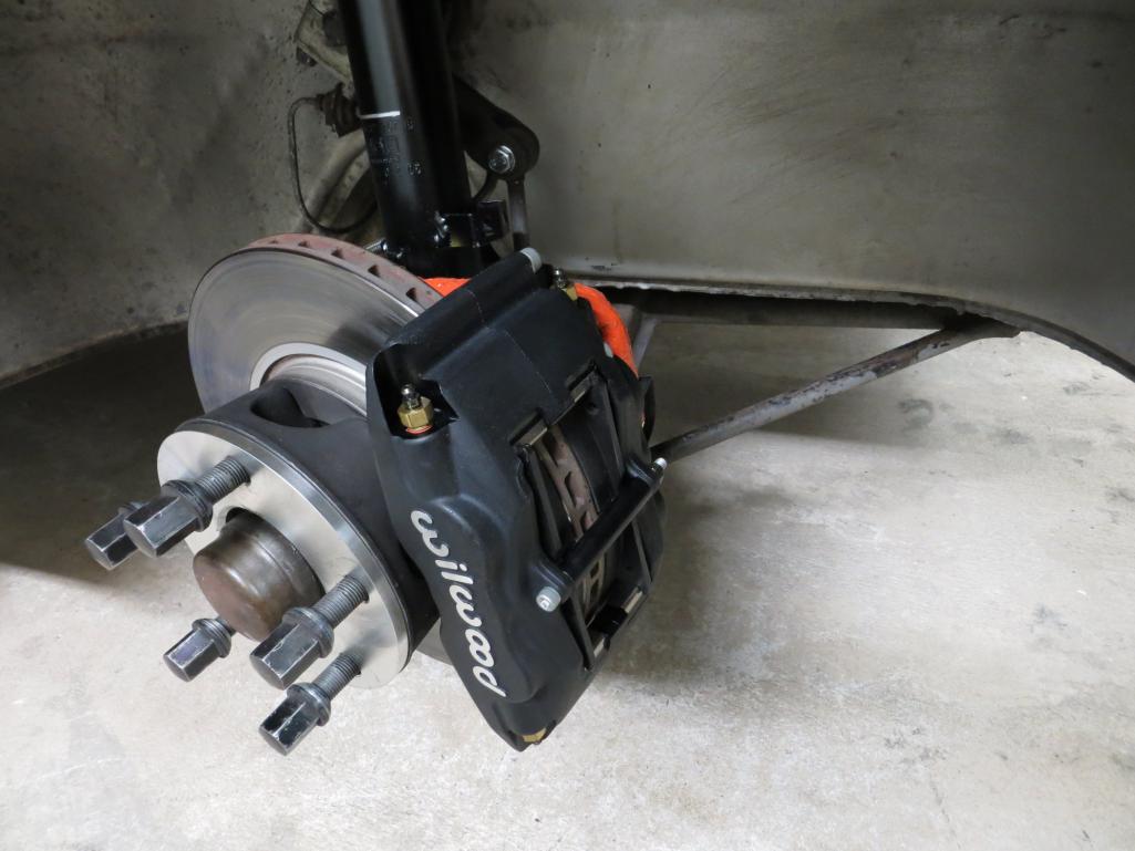

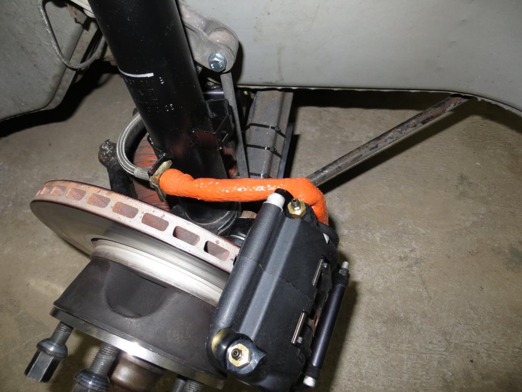

As well as swapped out my awesome Brembo AM calipers from Eric at PMB for a set of 4 piston Wilwoods with a lot more pad area and thickness. The Wilwoods were literally a bolt on with a 2mm spacer. Why more pad area? Mainly for better longevity and a slightly better heat sink. Of course this required a strut housing swap to go from 3" spacing to 3.5" spacing. Consider that thread your winter time entertainment (IMG:style_emoticons/default/chair.gif)
I also insulated the hard line which runs about an inch away from the rotor face with fire sleeve.
...and "while I was in there" I swapped out the stock bushings for Rebel Racing Teflon RSR setup.
Anyways, a couple of pics for your enjoyment!
