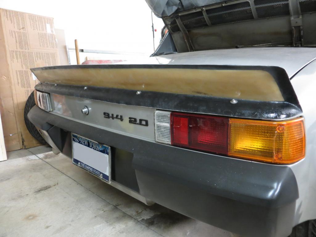

Finally added my Sheridan rear spoiler. One of the nicest aftermarket fiberglass components I have purchased.
Link to the "How-To" portion of installing the rear spoiler: http://www.914world.com/bbs2/index.php?s=&...t&p=2022462
