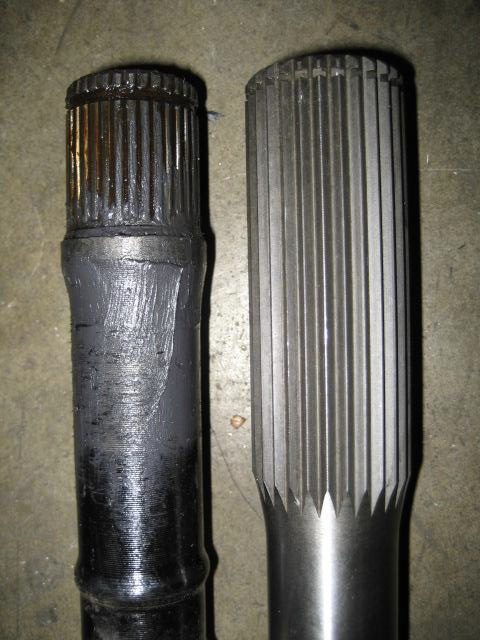

Here's you'll see my method for stub axle removal. A BFH and a cold chisel. Be careful to position the cold chisel on the "gasket" between the CV and the stub axle to avoid cranking on the metal bits:
(IMG:http://www.914world.com/bbs2/uploads/post-1110-1232675929.jpg)
They're here. Shiny new axles:
(IMG:http://www.914world.com/bbs2/uploads/post-1110-1232675956.jpg)
The right length too. You can see the difference when compared to the 911 units:
(IMG:http://www.914world.com/bbs2/uploads/post-1110-1232675941.jpg)
The threesome. Short = 911. The loaded shaft is a 914 shaft:
(IMG:http://www.914world.com/bbs2/uploads/post-1110-1232675995.jpg)
I want to emphasize the difference because you simply can't run 911 axles in a 914 (for very long). People have bolted them up but, they hyper extend the CV's and they're gonners in a short while.

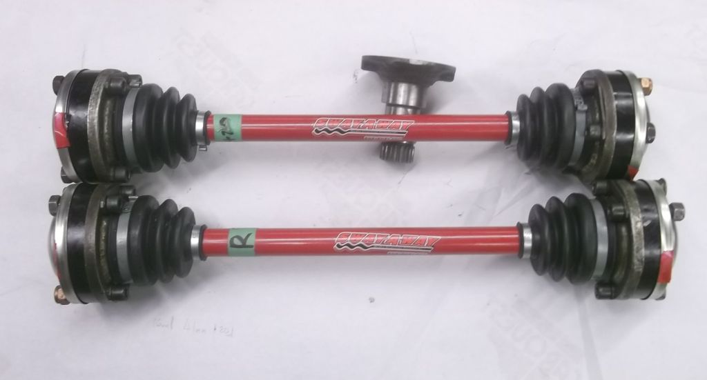

Harpo   Behold my new 914 axles with 911 C/V joints and sw...   Feb 23 2013, 04:26 PM
PRS914-6   For those of you considering this route the C/V j...   Feb 23 2013, 11:59 PM

Eric_Shea   Paul, he bought complete cv/axle assemblies that h...   Feb 24 2013, 10:11 AM
PRS914-6   Paul, he bought complete cv/axle assemblies that ...   Feb 24 2013, 10:24 AM

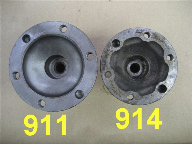

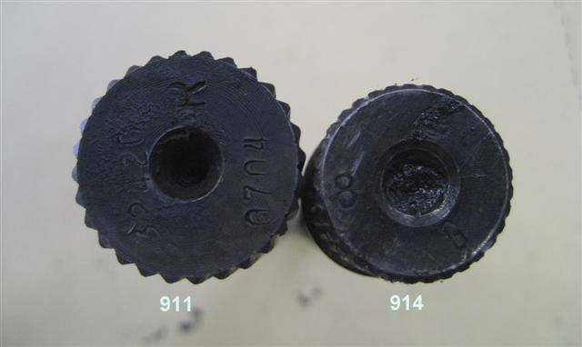

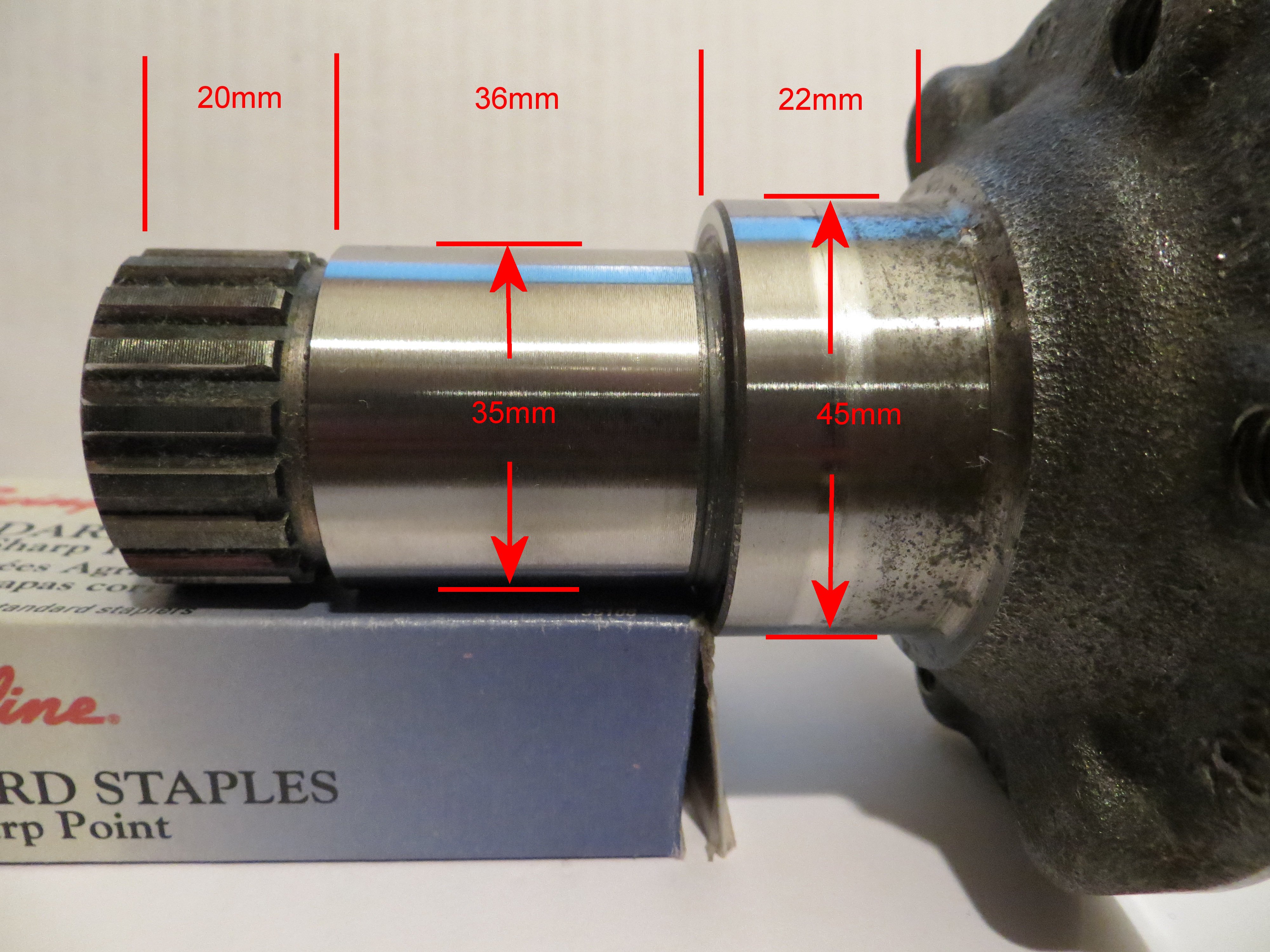

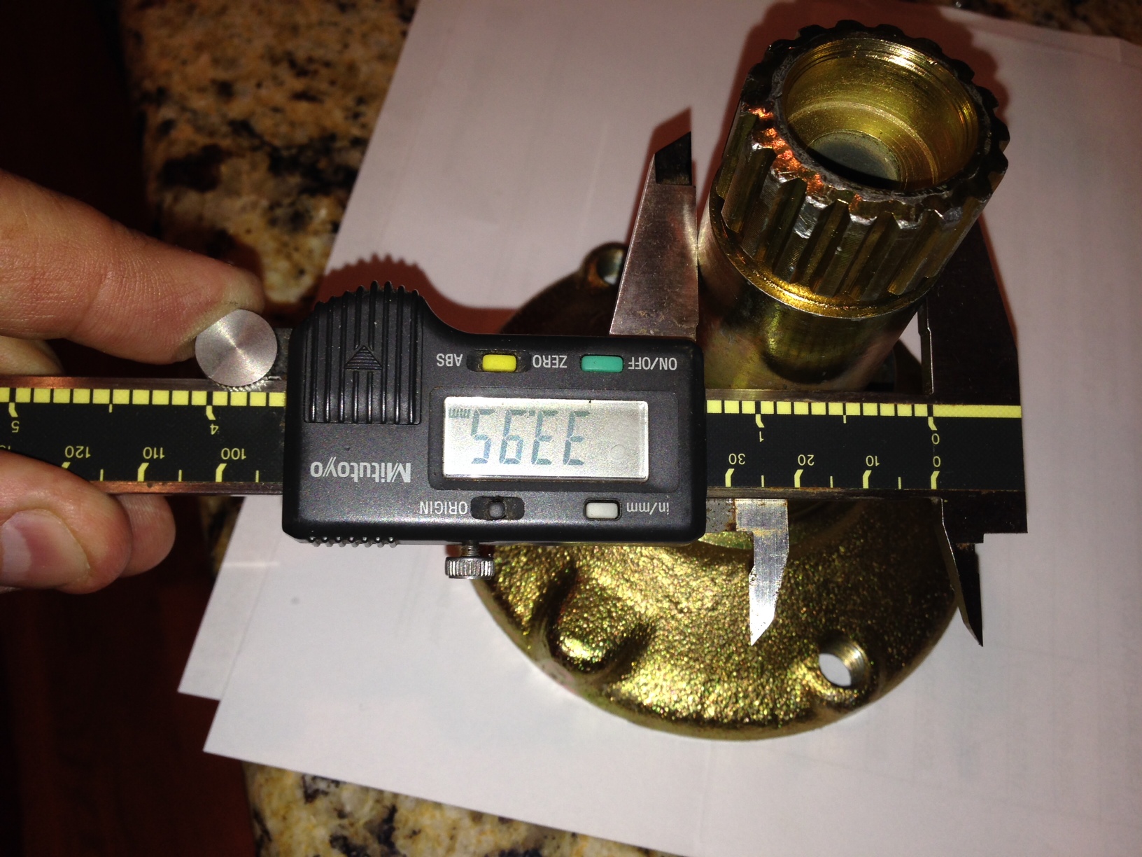

tomeric914   Adding to an already great thread... Dimensions o...   Aug 21 2013, 08:52 PM
PRS914-6   Adding to an already great thread... Dimensions ...   Aug 22 2013, 09:27 PM
Harpo   Adding to an already great thread... Dimensions ...   Sep 29 2013, 02:53 PM

chad newton   Ok, so what if you went with the newer style every...   Aug 22 2013, 08:06 PM
tomeric914   Ok, so what if you went with the newer style ever...   Aug 22 2013, 08:25 PM
chad newton   Ok, so what if you went with the newer style eve...   Aug 22 2013, 09:39 PM
PRS914-6   More comparison photos. You can clearly see the a...   Aug 22 2013, 09:18 PM
Eric_Shea   With a 915, be prepared to spend $4k+ convert...   Aug 23 2013, 04:33 AM
Mark Henry   For this you will need to get the 911-901 hubs, st...   Aug 23 2013, 08:03 AM

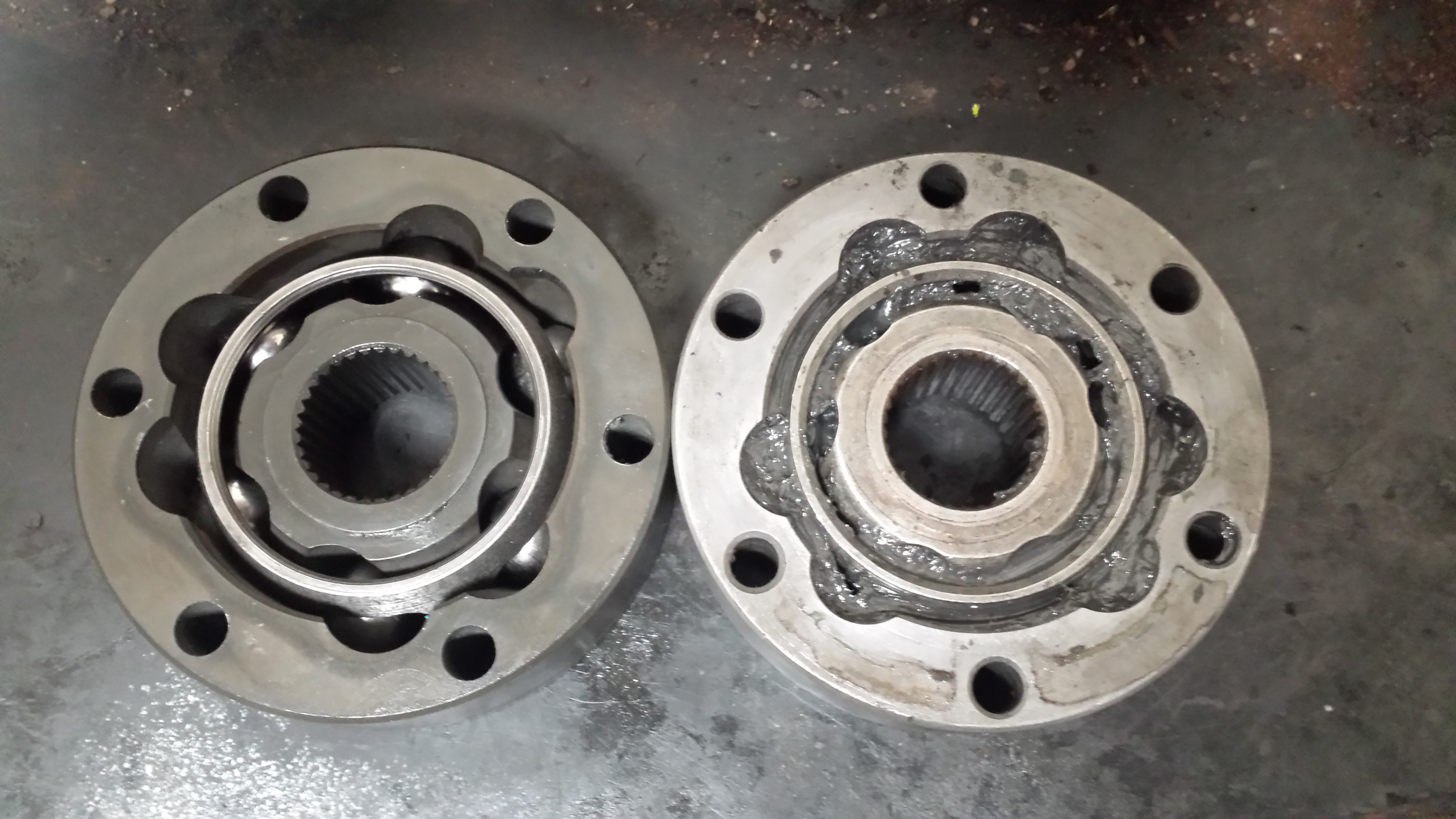

naro914   so...got a question here... I took apart all my CV...   Jan 15 2014, 12:42 PM
Mark Henry   You're looking for the 1974 to mid-75 CV The s...   Jan 15 2014, 01:16 PM
naro914   According to PP, (and other suppliers) the 69-mid ...   Jan 15 2014, 01:36 PM
Mark Henry   Pull out a bolt and see if it has a point/tit on t...   Jan 15 2014, 01:51 PM

Mark Henry   Ok some pics on thisfirst it's not just a ...   Jan 19 2014, 11:25 PM
Mark Henry   Difference in shaft lengths between the 1970 901 f...   Jan 19 2014, 11:27 PM
Mark Henry   This is the 1970 911/901 flange sitting in a 914-9...   Jan 19 2014, 11:31 PM
Mark Henry   This is the "sporto" (1969 901) flange s...   Jan 19 2014, 11:35 PM
Mark Henry   Oh.... and a bit of axle porn. :D Fully loaded a...   Jan 19 2014, 11:45 PM
Mark Henry   One question I have and I guess I should email Swa...   Jan 20 2014, 07:59 AM
Mark Henry   Yes the Swayaway axles are directional. Got an rep...   Jan 20 2014, 01:17 PM
