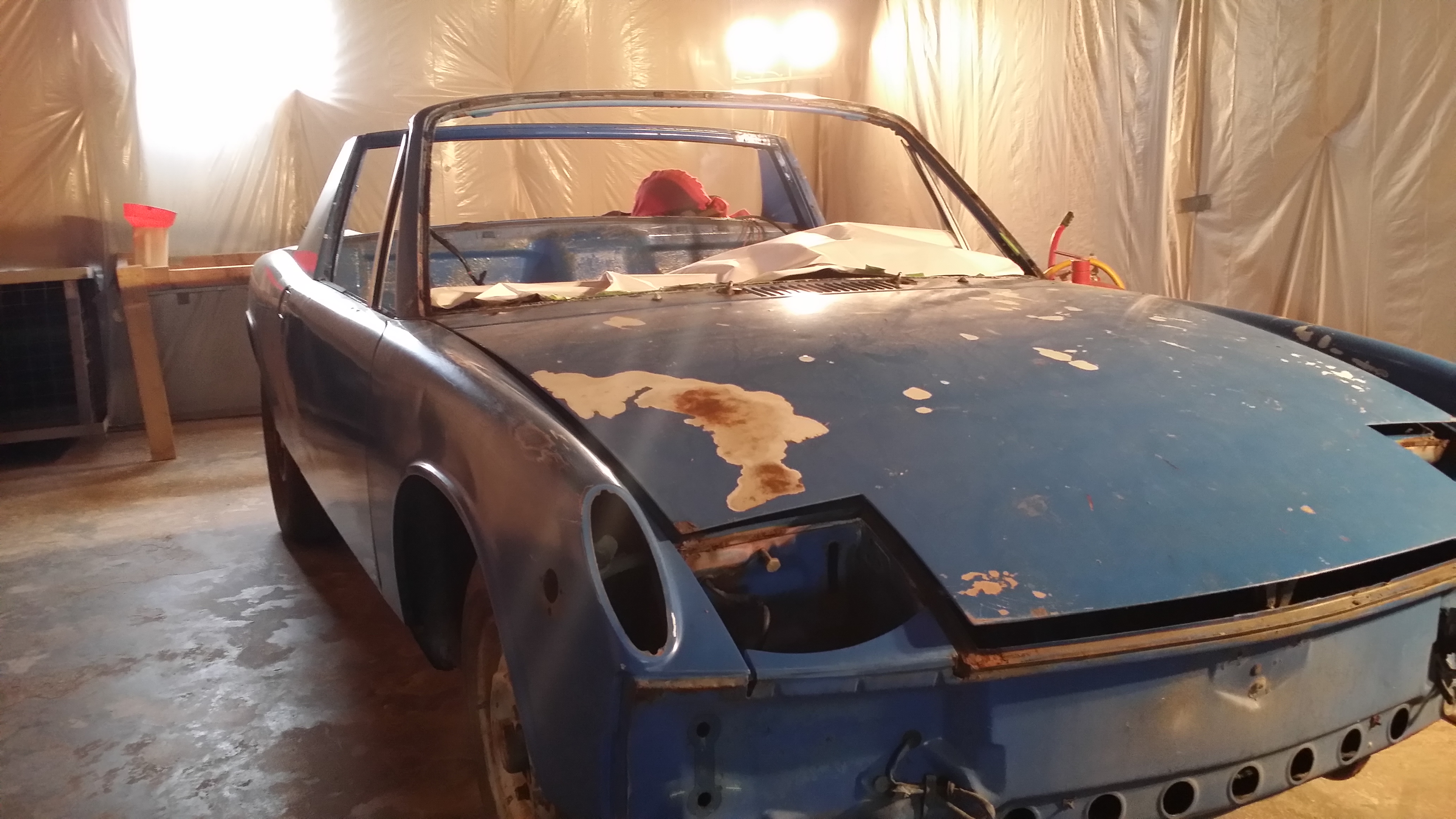

Hey guys, well here it is. My 71 1.7! I'm anxious to get started. First thing I want to do is sand the body down and start the primer process. First Question, what grit sandpaper should I use to begin with to start to get some surface rust off as well as the old paint? I want to get it down to metal and go from there, inside and out. The car also came with 2 trans and I want to know how I know which one came with the car? Sorry for all of the stupid questions, but I'm a nube! Also gonna post a link to more pictures in a post to follow this. I will also add the VIN number to the database on here...Attached Image

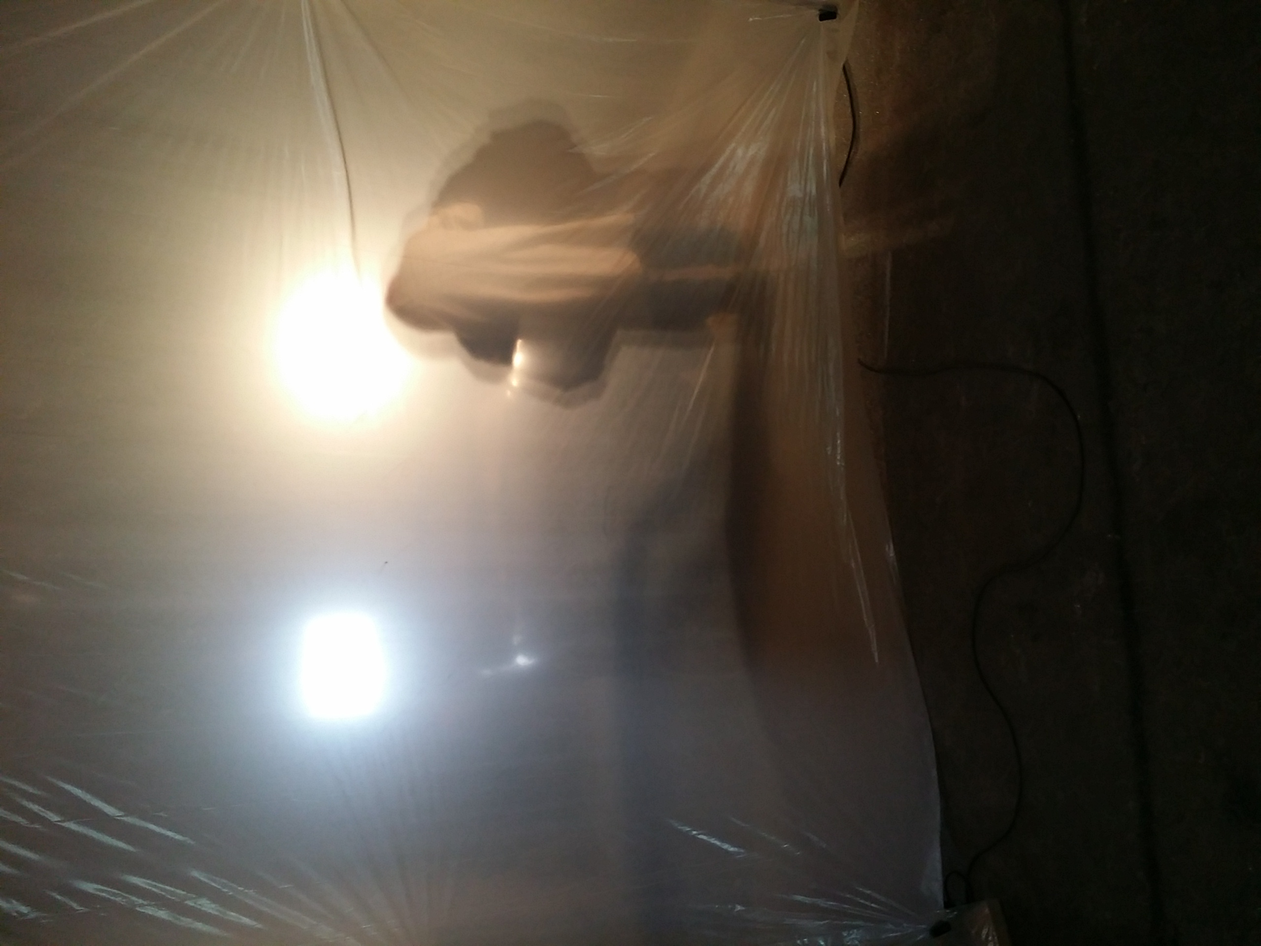

Media Blasting started today!!!

Sfreeman615   Media Blasting started today!!!   Apr 29 2014, 01:17 PM
Sfreeman615   First pass with a #3 Glass bead. Will go over the ...   Apr 29 2014, 01:19 PM
Mblizzard   Awesome! There is actually metal there!   Apr 29 2014, 03:33 PM
malcolm2   Got the windshield out.... great.   Apr 29 2014, 10:34 PM
Mblizzard   How is he going to rotate it to get below?   Apr 30 2014, 09:09 AM
