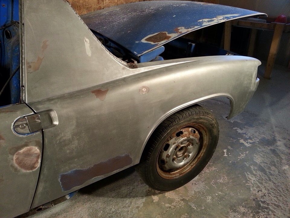

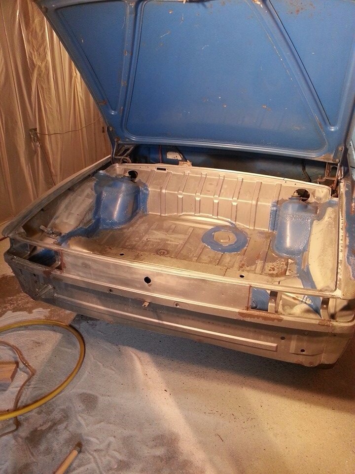

Sfreeman615   Dropped the car off at Restoration Media Blasting ...   Apr 9 2014, 07:16 PM
malcolm2   So you decided to rebuild and upgrade your engine ...   Apr 11 2014, 07:22 AM
Sfreeman615   So you decided to rebuild and upgrade your engine...   Apr 11 2014, 02:57 PM
Sfreeman615   Media Blasting started today!!!   Apr 29 2014, 01:17 PM
Sfreeman615   First pass with a #3 Glass bead. Will go over the ...   Apr 29 2014, 01:19 PM
Mblizzard   Awesome! There is actually metal there!   Apr 29 2014, 03:33 PM
