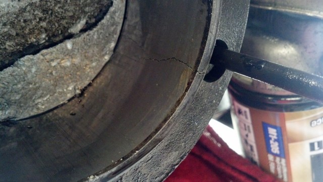

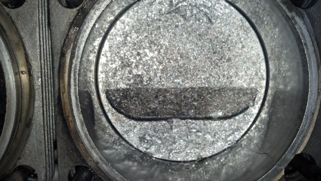

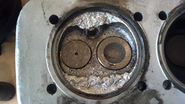

So, I was taking the long way home last Tuesday night after work. After about 15 minuets I got on the interstate and got up to around 75 when all of a sudden a loud knocking started.
I thought at the time that it sounded like a nut or bold fell into the combustion chamber somehow.
It sounded like a piston beating something up.
After a few seconds the sound quieted down a bit. By this time I knew the damage was already done. So, I "limped" it home.
I was finally able to pull the engine today and this is what I found...
Now, I am not missing any nuts or bolts from my ventures, or studs from my intake.
I had my air cleaners on with the rain hat covers on my 40 idf webers.
And spark plugs are damaged, but complete.
It looks like a stud or bold.
Any ideas where this could have come from?

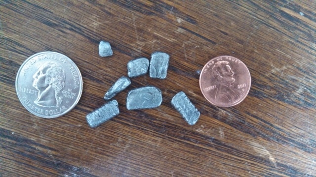

Here is a better picture of the pieces I found in the intake and the damage done to the head, piston, and cylinder.

cwpeden   Definitely looks like the remnants of a stud or se...   Apr 29 2014, 12:12 AM
vw_porsche   Definitely looks like the remnants of a stud or s...   Apr 29 2014, 08:25 AM
yeahmag   Can you see if the piston is missing a chunk? That...   Apr 29 2014, 11:45 AM
vw_porsche   Can you see if the piston is missing a chunk? Tha...   Apr 29 2014, 12:17 PM
stugray   Please explain how those pieces got "munched...   Apr 29 2014, 12:15 PM
vw_porsche   Please explain how those pieces got "munched...   Apr 29 2014, 12:20 PM
yeahmag   Man... Being ferrous and in the intake like that I...   Apr 29 2014, 12:21 PM
vw_porsche   Man... Being ferrous and in the intake like that ...   Apr 29 2014, 12:40 PM
Cupomeat   [quote name='yeahmag' post='2030920' date='Apr 29...   Apr 29 2014, 12:42 PM
yeahmag   I think you need to look above that. Were you runn...   Apr 29 2014, 02:36 PM
vw_porsche   I think you need to look above that. Were you run...   Apr 29 2014, 03:28 PM
The Cabinetmaker   Those got ingested thru the carbs. No way they wer...   Apr 29 2014, 02:52 PM
yeahmag   I would inspect the carbs and intake manifolds car...   Apr 29 2014, 03:47 PM
r_towle   Bummer.... Time for a boroscope from Home Depot.....   Apr 29 2014, 06:36 PM
Elliot Cannon   Shanghai Tool Supply. :D http://www.harborfr...   Apr 29 2014, 06:44 PM
yeahmag   I personally don't see the need for a borescop...   Apr 29 2014, 06:54 PM
r_towle   I personally don't see the need for a boresco...   Apr 29 2014, 07:15 PM
yeahmag   What the hell was I thinking? You're right. We...   Apr 30 2014, 11:16 AM
stugray   How about the screws that hold the butterfly valve...   Apr 29 2014, 07:15 PM
vw_porsche   How about the screws that hold the butterfly valv...   Apr 29 2014, 07:20 PM
rgalla9146   How about the screws that hold the butterfly val...   Apr 30 2014, 12:04 PM
cwpeden   When did you put the rain hats on? Did it require ...   Apr 29 2014, 11:48 PM
vw_porsche   When did you put the rain hats on? Did it require...   Apr 30 2014, 10:58 AM
cwpeden   I guess all we have left is sabotage.... :smash:   Apr 30 2014, 12:01 PM
toolguy   Comparing them to the size of the thread stitching...   Apr 30 2014, 12:50 PM
vw_porsche   Here is a better picture of the pieces I found in ...   Apr 30 2014, 01:51 PM
yeahmag   Show us the spark plug.   Apr 30 2014, 02:01 PM
vw_porsche   Can't get a Pic of that at the moment (at work...   Apr 30 2014, 02:10 PM
Qarl   That will buff right out. OUCH... that looked pai...   Apr 30 2014, 03:28 PM
toolguy   :blink: any updates what it was ??   May 5 2014, 09:20 AM
vw_porsche   :blink: any updates what it was ?? No, I have...   May 5 2014, 09:33 AM
ThePaintedMan   What kind of air filters were you using? If foam, ...   May 5 2014, 09:37 AM
vw_porsche   What kind of air filters were you using? If foam,...   May 5 2014, 09:47 AM
Mblizzard   Done it! Sucks but I got the t-shirt.   May 5 2014, 09:42 AM
