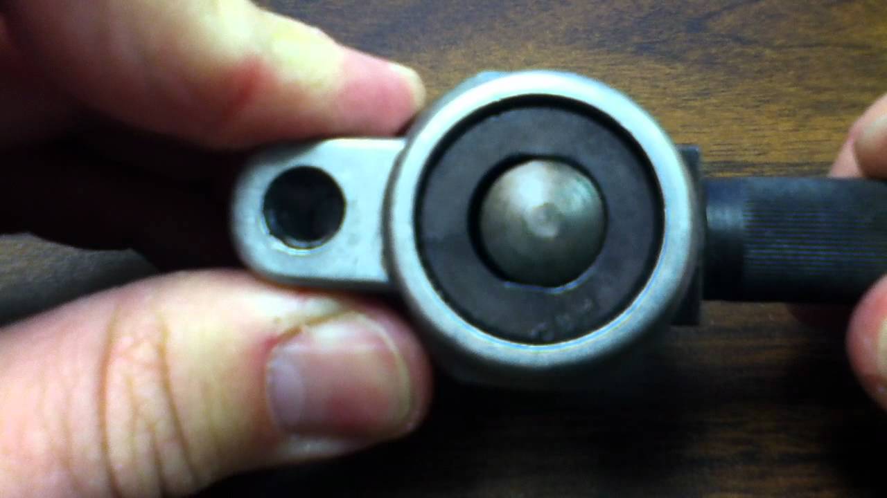

I am replacing my shift coupler bushings.
I purchased a white delrin set and they were way too sloppy and a poor fit. (IMG:style_emoticons/default/headbang.gif)
Next up is a set of urethane and they fit much tighter but the pin still floats around in the holes which appear to be oval shaped? Not sure if I would like that play due to the pin floating in the oval shaped holes. (IMG:style_emoticons/default/blink.gif)
I saw a set of solid brass bushings, these look interesting. (IMG:style_emoticons/default/shades.gif)
Has any one used them? (IMG:style_emoticons/default/idea.gif)
Are the pivot holes supposed to be oval shaped with slop around the pivot pin? (IMG:style_emoticons/default/idea.gif)
Any brand better than others? (IMG:style_emoticons/default/idea.gif)
There seems to be a lot of manufacturers out there and the prices go from $12 bucks to $40.00 for the brass ones. (IMG:style_emoticons/default/shades.gif)

The ones currently supplied are for the 911. 914 will have round holes if you can find them.

QUOTE(SLITS @ Apr 30 2014, 09:36 PM) *
This must be the 911 bushing like the ones I got.
Thanks for the info guys ! (IMG:style_emoticons/default/beer.gif)
