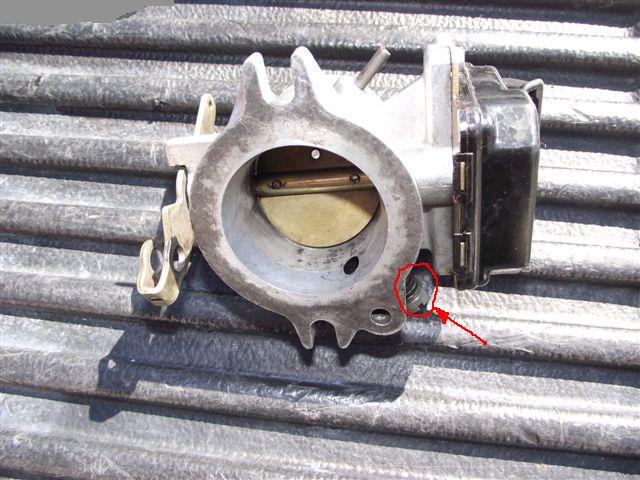

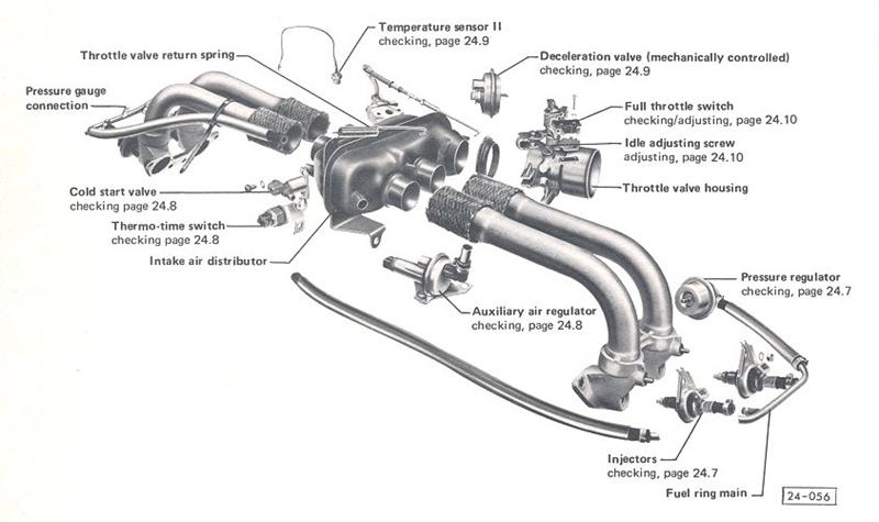

Larmo63   I have an idle issue now that the final vacuum hos...   May 3 2014, 07:31 PM
dw914six   I have an idle issue now that the final vacuum ho...   May 3 2014, 09:12 PM
Larmo63   Thanks, ......anyone on how to lower the idle on a...   May 3 2014, 10:47 PM
KELTY360   There's an adjusting screw on the throttle bod...   May 3 2014, 11:09 PM
euro911   Idle adjustment is the big screw on the throttle b...   May 3 2014, 11:13 PM
Larmo63   I can't see any screw that looks like an adjus...   May 4 2014, 12:14 AM
euro911   RE: "Excited Newbie Blues"   May 4 2014, 01:25 AM
Larmo63   That screw is all but impossible to reach with the...   May 4 2014, 12:21 PM
euro911   You just have to thread your arm and hand back dow...   May 4 2014, 02:11 PM
Larmo63   It just doesn't seem very "German" t...   May 4 2014, 02:28 PM
euro911   I thought dealing with the brakes was the first ch...   May 4 2014, 08:34 PM
mdelwiche   I thought dealing with the brakes was the first c...   May 4 2014, 10:32 PM
boogie_man   I thought dealing with the brakes was the first c...   May 5 2014, 12:41 PM
914_teener   Check the rotors for wear as well........375 no le...   May 5 2014, 01:18 PM
Spoke   Idle at 2k is quite high even for the adjustment. ...   May 5 2014, 03:01 PM
Larmo63   That IS the hose I have plugged (for now) and the ...   May 5 2014, 04:28 PM
Spoke   That IS the hose I have plugged (for now) and the...   May 7 2014, 12:58 PM
