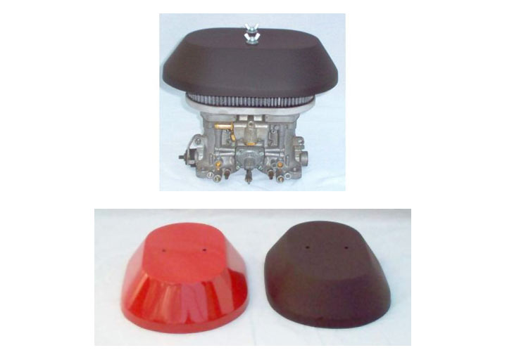

What kind of air filters were you using? If foam, it's possible that somehow a bolt was wedged in between the foam and the screen but you never saw it. Then eventually it worked its way loose. I'm sorry to see the damage, but rest assured that you're certainly not the first or last person to have it happen to them.

I have these filters with rain hats on top.
