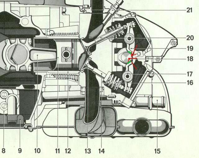

Maybe a simple question... is the back side of a cam lobe normally a "circle". That is, about 180 degrees of the cam lobe could be used to measure the values and it doesn't really need to be exactly at TDC?
(IMG:http://www.914world.com/bbs2/uploads_offsite/forums.pelicanparts.com-7335-1399486506.1.jpg)

wobbletop   Maybe a simple question... is the back side of a c...   May 7 2014, 12:15 PM
