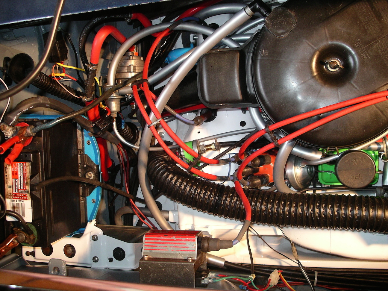

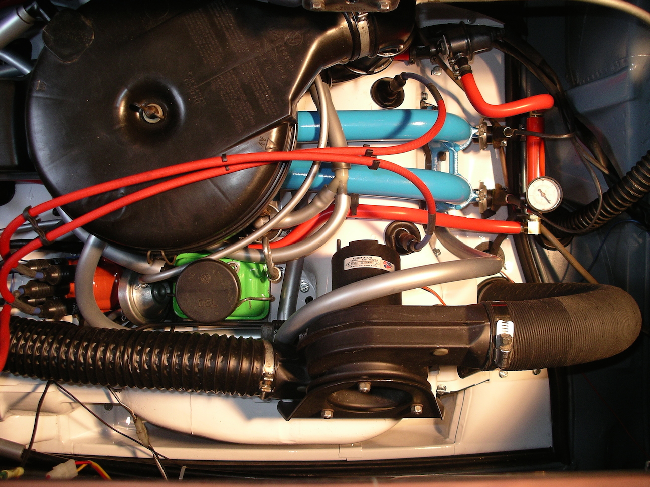

Looks like you're doing a great job with your re-build. I came in looking to see if anybody had a recommendation on where to get 1.7L Heads (mine are finally shot), but I see that you are going way beyond what I am able to do.
I've owned my '72 1.7L since 1982 and it is my constant project (very fun project). One thing that I did about 20 years ago with my first engine rebuild was that I hard all the engine sheet metal bead blasted, zinc plated, and powder coated. The zinc plating keeps the rust away. I chose white powder coating and it really lightens up the engine compartment when everything is back in the car. Here are a couple of pictures.
