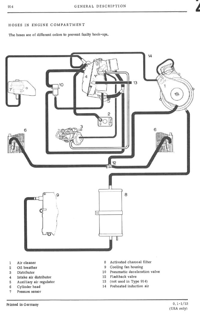

QUOTE(r_towle @ May 10 2014, 09:09 PM) *
Is the PVC valve supposed to connect to the plenum?
I believe it's supposed to connect to the air cleaner.
From what I gather it only connects to the air cleaner on '75 and '76 cars. Earlier cars it connects to the plenum.
http://www.914world.com/bbs2/index.php?act...t&id=424473
