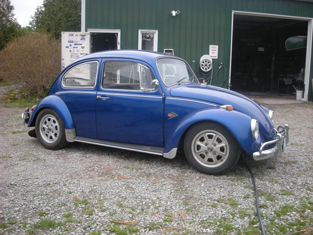

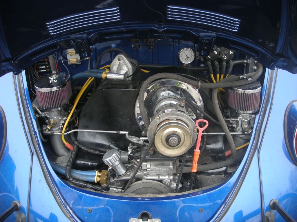

Mark Henry   It's alive :thumbsup:   May 14 2014, 11:24 AM

Moneypit   Pardon my noobiness, but as I understand this, usi...   May 14 2014, 01:04 PM
Mark Henry   More than just the sound, on an engine my size (10...   May 14 2014, 08:28 PM
crash914   Looks good Mark...very similar to my motor...103 x...   May 15 2014, 02:52 AM

rhodyguy   the fuch wheels look sharp on your t1.   May 15 2014, 07:39 AM
Mark Henry   I don't think it will need wheelie bars, she...   May 15 2014, 08:23 AM
Qarl   Post a video of it running... (and some throttle b...   May 15 2014, 08:24 AM
Moneypit   This is now relevant to my interests... I have car...   May 15 2014, 09:05 AM
Mark Henry   Everything on this build is custom, between the en...   May 15 2014, 10:52 AM
Moneypit   Everything on this build is custom, between the e...   May 15 2014, 11:41 AM
Mark Henry   [quote name='Mark Henry' post='2037804' date='May...   May 15 2014, 03:01 PM
crash914   Mark, I am using 30# per hour injectors in mine......   May 15 2014, 11:48 AM
