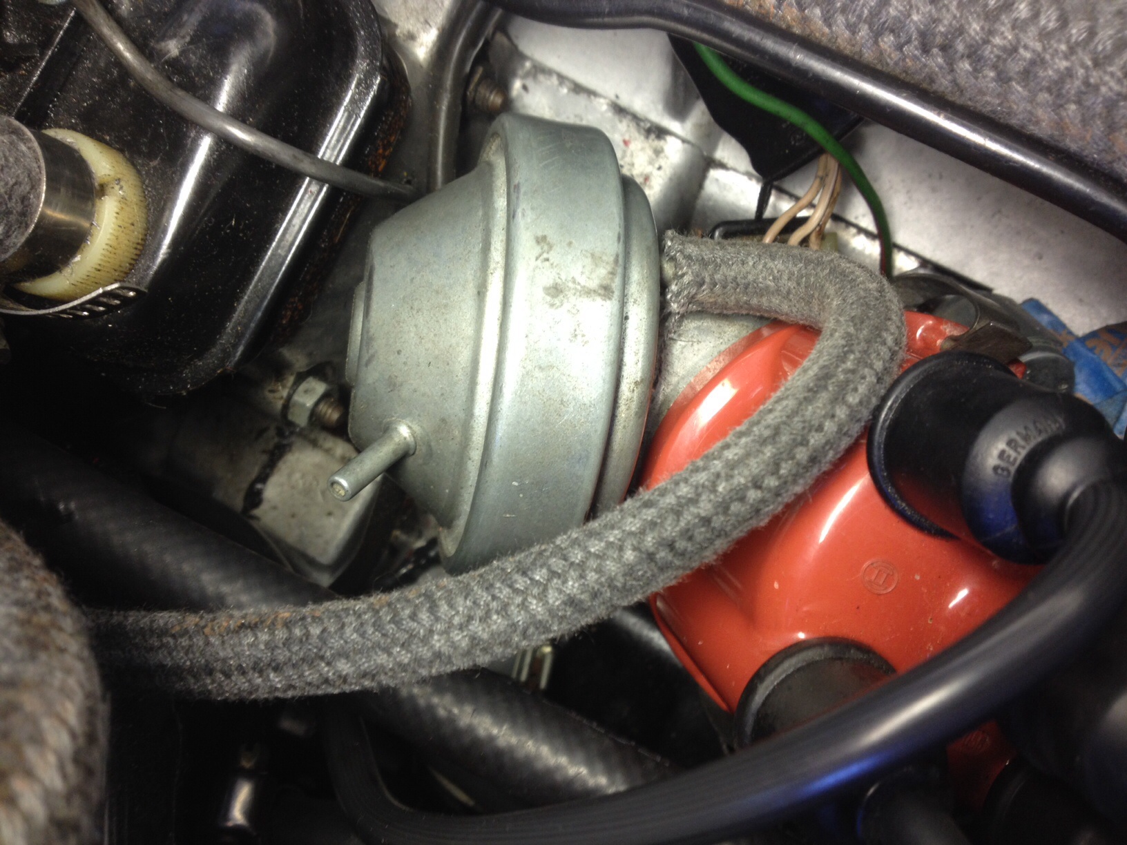

This can be tough! As a suggestion, if you have not done so, pull all 4 plugs it makes engine rotation so much easier.
First, before you change anything, are you sure that you are viewing the correct mark on the impeller? TDC should display a "0" in the v notch like this
Remember the impeller makes two revolutions for one turn of the dizzy. If you are at TDC on #1 your rotor should be pointed at #1 as shown below. Which should be in the general area if the inspection hole. If I remember correctly, the 12 degrees refers to the orientation of the distributor drive gear not the rotor.
If the rotor is in the general area of #1 then you likely don't need to rotate the dizzy. If the rotor is pointing at #3 the you are off.
Because the car ran before the change, I would think that it would be best get it running again before changing anything else like pulling the dizzy.
Once you are sure that you are at TDC, regardless of where the rotor is pointing verify that the wires are attached to the cap in the correct firing order 1, 4, 3, 2. If they are not in that order then place them correctly.
Now at this point the car should be in a position to start. If the rotor was not pointing at #1 and you moved wires then you may have to move the dizzy to get it to start. Sometimes it is best to get someone to start the car while someone else rotates the dizzy.
If it runs and you moved the wires then at that point you can decide if you want to pull the dizzy to get the rotor to point at #1 as shown in the photo.
On the 2.0, the vacuum advance can on the dizzy blocks the hold down nut. If you have to pull the dizzy, you will need to loosen the 10 mm hex bolt and rotate the dizzy so the the vacuum can is facing toward the rear of the engine to get at the 13 mm hold down nut. If you remove the dizzy the o rings will be fine.
