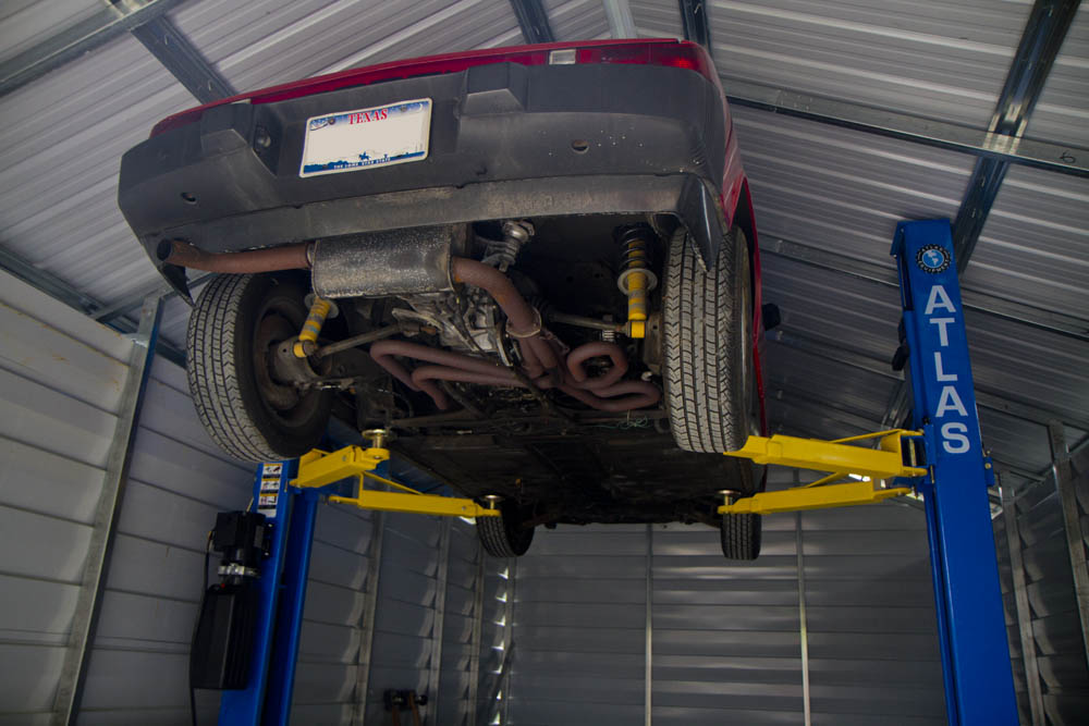

I spent $1400 on a 2 post lift, $300 on tax/shipping, and $300 for a pro to install it. Worth every penny especially since I'm doing a /6 conversion. Up and down with the push of a button - life is easy. It's pretty much a lifetime investment too!
(IMG:http://www.914world.com/bbs2/uploads_offsite/i.imgur.com-10741-1400704200.1.jpg)

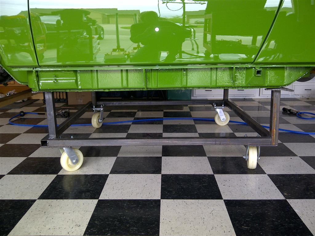

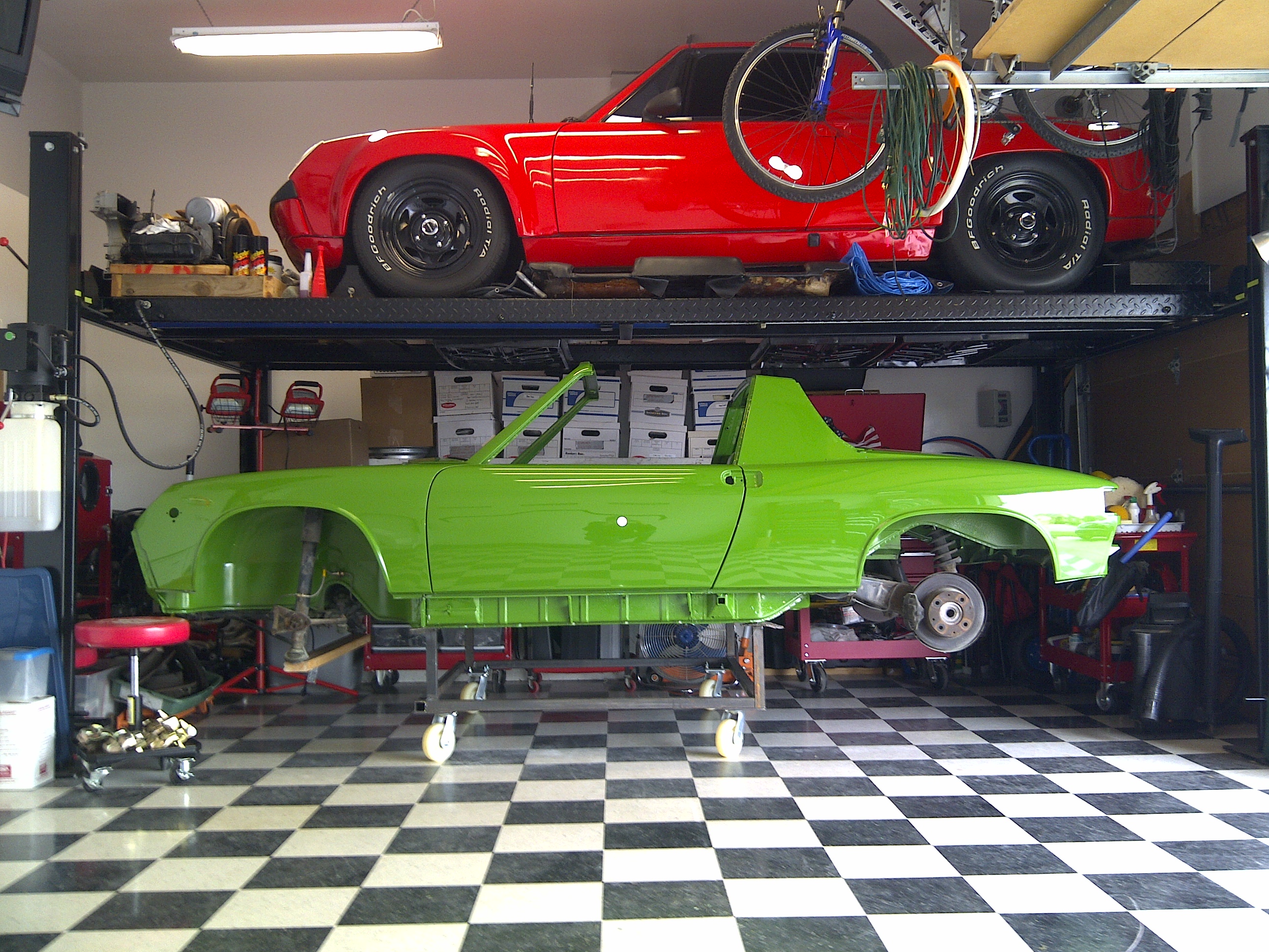

$50 worth of 2" square tube and a borrowed MIG welder. The casters are from my 4 post lift.
