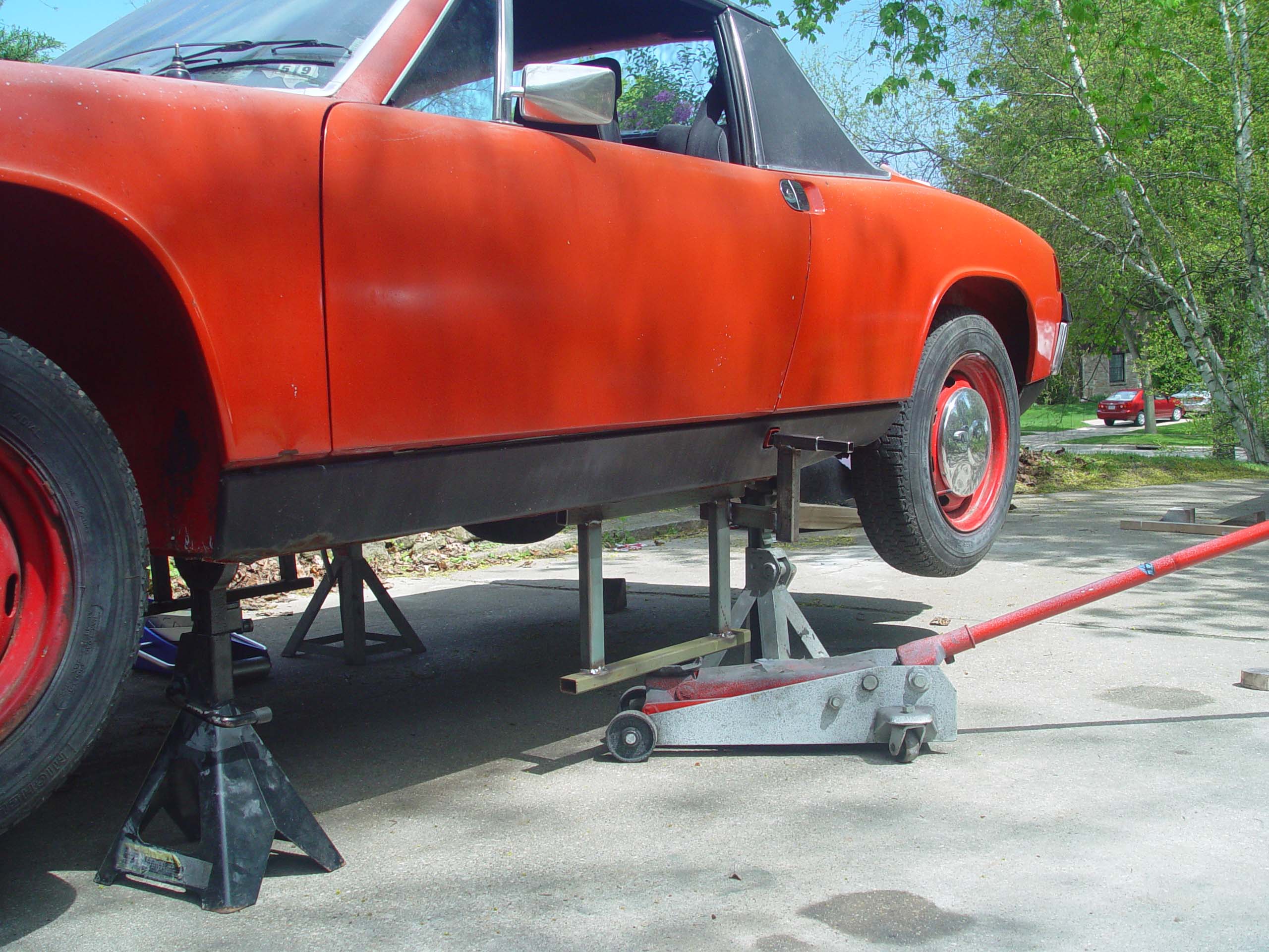

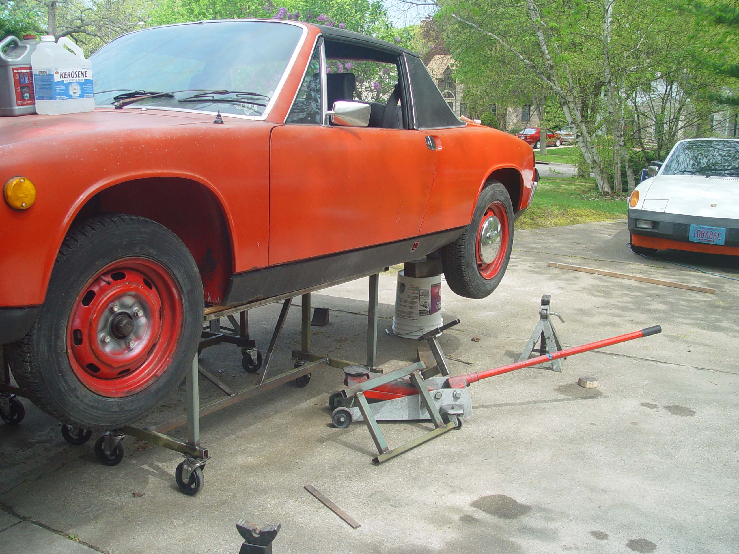

My problem was getting it high enough. So I put the tub on jack stands and then put an extension under the frame rail that also was plugged into the jack point hole so it wouldn't wobble.
Then when that was lifted up I had about 30".
Yes, having the car on just two jack stands was a bit of a balancing act. I treated it like a horse (as though I know how (IMG:style_emoticons/default/lol-2.gif) ) . One hand on it all of the time and not under it, or even close to under it.
Now I can wheel it around. The advantage of plywood is it resists racking forces and when put together right has it all - racking, tension, load and works as a beam. But, you have to make them right. My previous car sat on a pair of 1/2 in plywood stands that I can knock down in a minute to flat pieces.
I went with steel because it is very strong and in the end you take it apart with an angle grinder and make something else.
