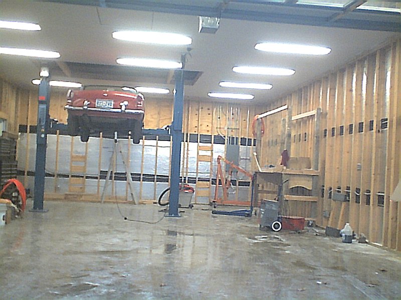

This has pretty much been covered, but as a summary of sorts I have to say get whatever sort of lift your budget can accommodate. Unless it literally keeps you from being able to buy food for your family, you will kick yourself for not doing it sooner.
I bet 99% of the people here work on their cars because they enjoy it. Lying on your back in the dirt is _not_ conducive to enjoyment. Sounds silly but it took me years to realize that. My only regret after getting a lift was not doing it sooner.
Admittedly, I'm spoiled. Back when I had more money but no time to be scouring Craigslist and the like, I splurged on a Nussbaum 2 post.
Gratuitous pic. Funny how shop looks so huge in the pic and now I can barely walk through it to do anything. Need to to get out there and clean up.
