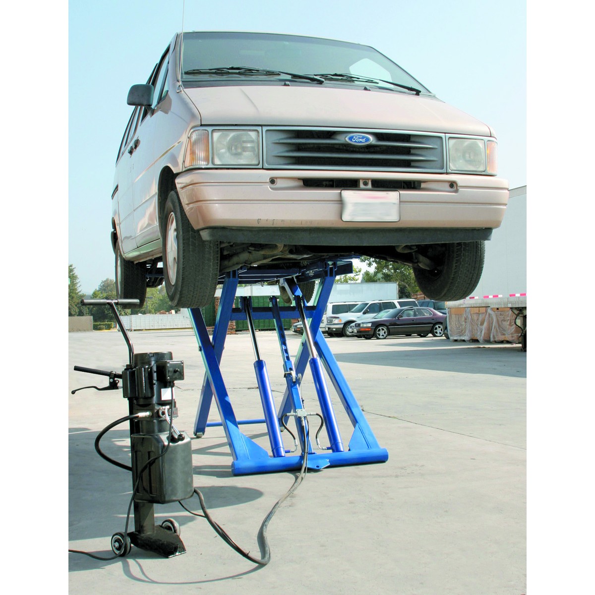

Steve   I love my Bendpak MD-6XP scissor lift. It runs on...   May 20 2014, 09:51 PM

MMW   Anyone ever see these in person or use them? http...   May 21 2014, 05:12 AM
bulitt   Those are cool. The price must be a big secret? ...   May 21 2014, 06:14 AM

Elliot Cannon   Mid rise scissor lift. One of my best investments...   May 21 2014, 12:05 PM
bulitt   :agree: My B in Law just picked a used one up on...   May 21 2014, 02:22 PM
