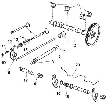

Picture below show all parts involved.
Cause of defect can be Part # 1,2 or 15 right ?
Part # 16, the rocker ? Parts Catalog say Number is same on all motors.
only diffrence is intake and exaust cause of arm angle and 8 or 10 mm adjust screw. It is an cast iron Part hardened at the ends right ? Can become cracket but most time not bent.
I would exclude this part from the list
Have you checked the engine number ? Is your motor a Bus Motor with hydraulic lifters or modified ?
Push rods are all in the same length ? Check this first by eye. Hardened end are not damaged ?
A depht measurment starting from the edge of the cylinder-head
down to the hydraulik lifter (or lifter only) can help check both, cam and lifter.
If the cam is damaged, you have the same depht on the cylinder with the valve problem and the opposite side. ( Compared to the depht on a cylinder everything is working fine there must be a different)
If the there is an issue with the (hydraulik) lifters thre must be a measurment difference between the cylinder with that issue and the opposite side.
If your motor was not running for a long time or has been striped down, also hydraulic lifters without issues can loose oil and that will adulterate your measurment.
All measuring must be done while the cam pin is on the upper.
Any error in reasoning guys ? (IMG:style_emoticons/default/idea.gif)
