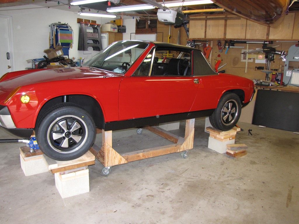

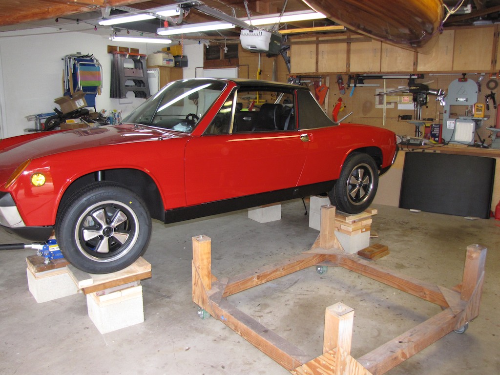

QUOTE(Steve_R @ May 20 2014, 07:41 PM) *
I made this from some 4X4s and 4 casters.
You can even have Home Depot make all of the cuts and you just screw it together.
How do you get it high enough to get up on the rollers?

QUOTE(Alphaogre @ May 23 2014, 06:50 PM) *
I use 2 X 6s and 12 X 12 concrete blocks and a floor jack. It takes about an hour to get it down. I only used this dolly for the restoration. I don't plan to put it back on the dolly.

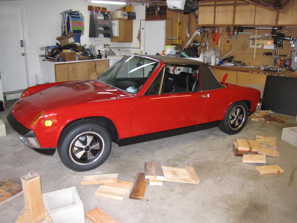

Steve_R   I made this from some 4X4s and 4 casters. You can ...   May 20 2014, 08:41 PM

Alphaogre   I made this from some 4X4s and 4 casters. You can...   May 23 2014, 07:50 PM
