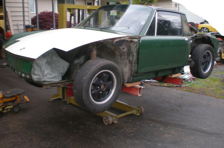

I've been trying to figure out how I can support the car off the ground so its easier to work on. I was thinking of 30" or so. I've seen some tall jack stands, but they don't have a very wide base. There's no engine in the car, but hat and the tranny are the only part not installed. I was going to borrow a scissor jack, but it requires 230 and i only have 110 in the garage. any ideas? Blocks under the wheels?

914forme   EZ-carlift several of us on the board have them, w...   May 20 2014, 05:32 PM

Steve_R   I made this from some 4X4s and 4 casters. You can ...   May 20 2014, 08:41 PM
