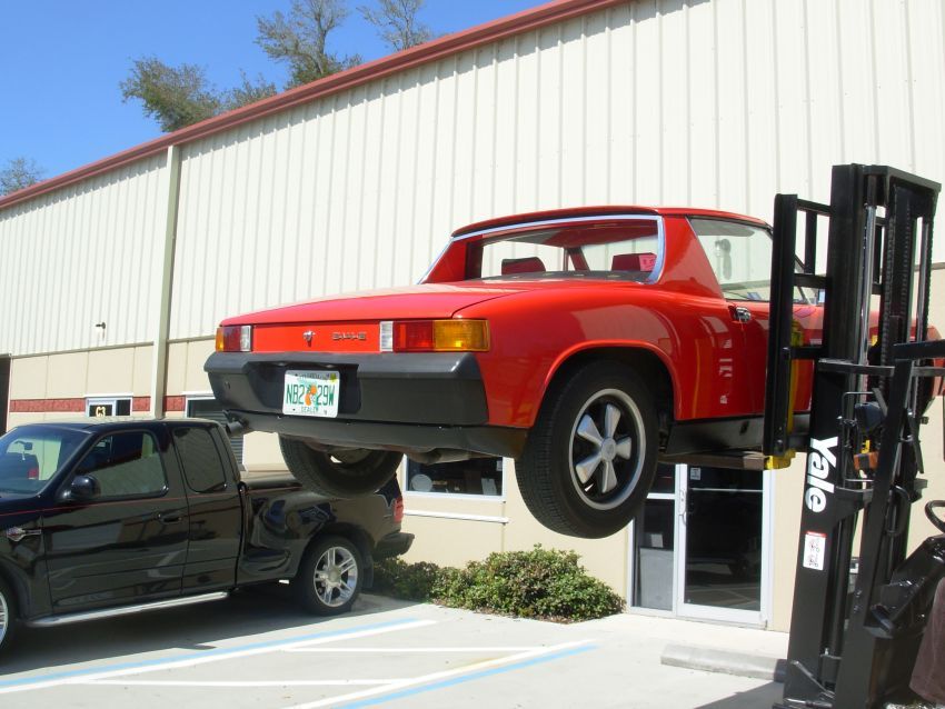

rick 918-S I thought I had a better photo of the stands I use... May 20 2014, 09:08 PM
