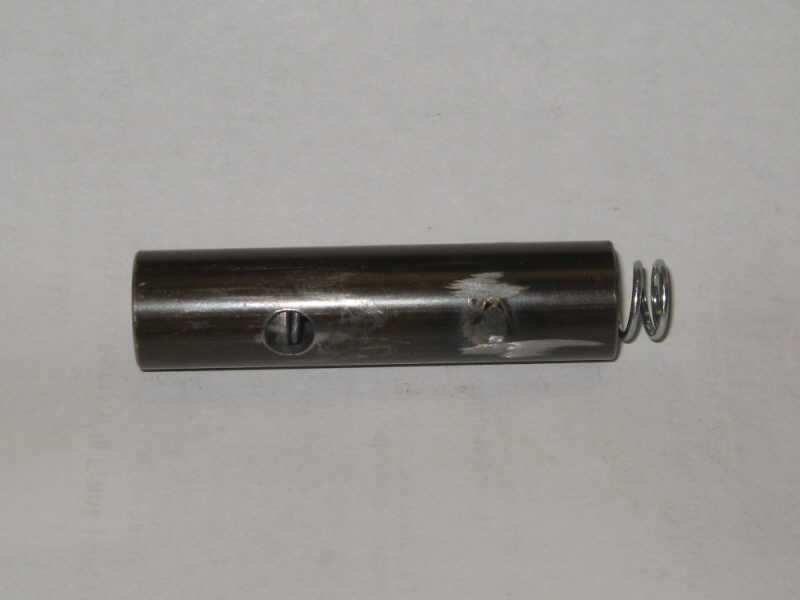

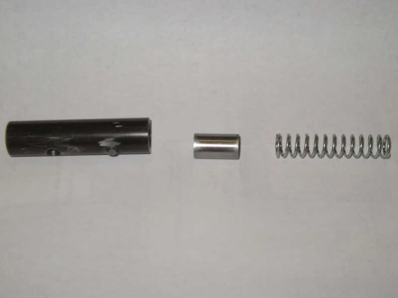

Here's my prototype pressure relief which eliminates the cooler bypass.
The opening pressure is estimated at 60 psi. Fine tuning may be necessary, and is done by varying the piston length to change spring preload.
Added features not shown include an o-ring seal at the top, and a screw to retain the spring.
The head of the screw will double as an alignment feature so the bypass holes line up correctly. (weld build-up visible was intended as the alignment feature)
