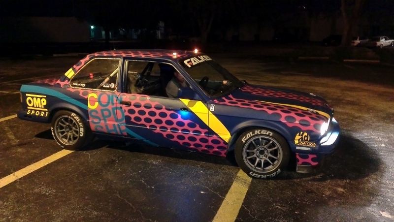

Ill look for you George. Look for a PM from me with contact info.
Condor Speed Shop and MAD Motorsports are the two teams that I work/hang out with. You wont be able to miss the MAD trailer; its a 53' car hauler with MAD vinyl all over it.
Here is the car:
(IMG:http://www.914world.com/bbs2/uploads_offsite/dl.dropboxusercontent.com-16683-1400672291.1.jpg)
Get in the car for Chump @ Sebring! George will be Driving, I will be Driving!
Of course you will be driving for 2nd Place!
