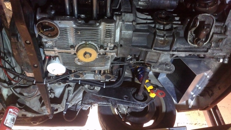

Cooler installed!
(IMG:http://www.914world.com/bbs2/uploads_offsite/dl.dropboxusercontent.com-16683-1401454348.1.jpg)

Cooler installed!
[/quote]
Miguel
Let us know how this works out for you. When I installed my Tangerine Racing street headers, it moved most of the plumbing to the drivers side. I thought this location would be perfect. When I didn't see much improvement, I realized that I was probably picking up a lot of engine heat from the impeller. I moved the cooler higher and added a NACA duct on the right side rocker panel. Not sure how effective that is yet, but Foley has used that position with positive results, he says.
