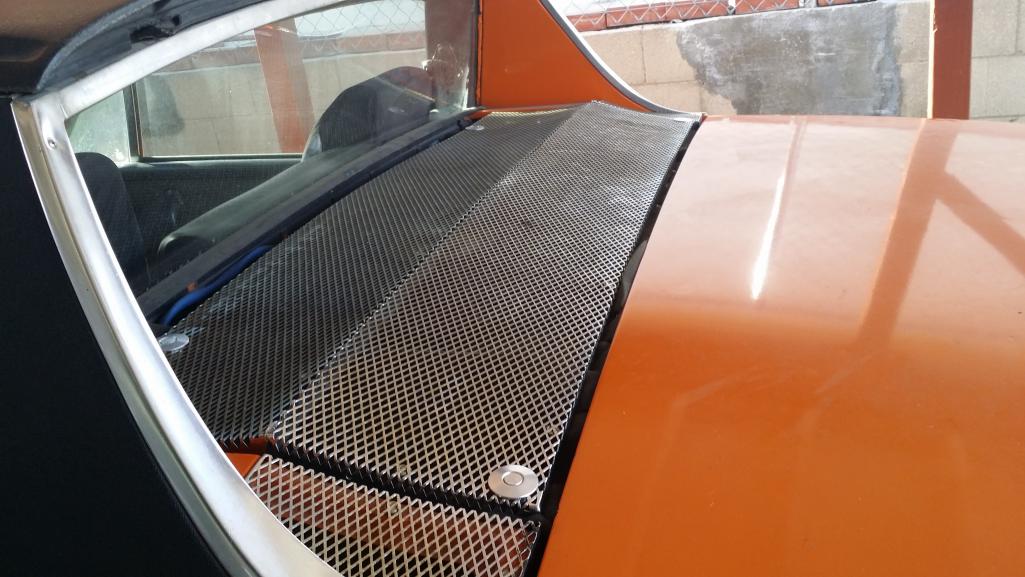

I have made my own GT style lid from two chrome grills. It's held down with quick-latches. I think it looks OK for now. until I clean up my cooling system a bit, speaking of which,,,
I've driven her on 100 degree days now, still no overheats. I was a bit low on water too. On normal days my car is a cool running cat. I want to sort my suspension, but I don't know where to begin. I had a fellow teener hop behind the wheel of my car for an evaluation run. John was pretty impressed, despite the fact that he wasn't used to my gear box and couldn't find 1st. When the test drive was over,, I suggested that he pull on the ebrake lever with some force,,, only one side is currently working. Pop! went the cable inside the cabin. bummer,, oh well I have a wtb add up.
anybody local want a ride? I have the FI 95% done and she feels pretty good! I'm thinking about adding heat now,,,,
I'd love to see more details of your latch setup...
