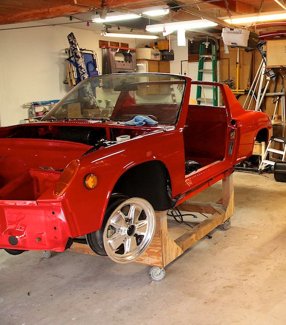

More pics

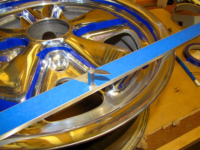

Marc,
That's a great idea. My car didn't have a debris shield so I didn't think of putting it there. Does anyone have any pictures of this?

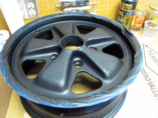

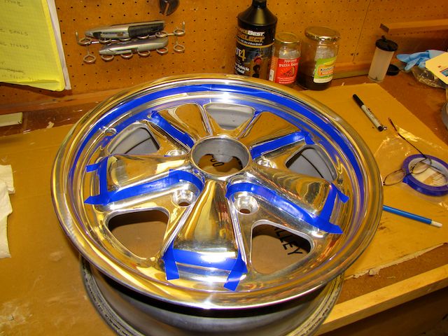

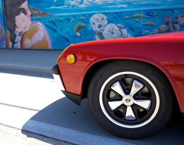

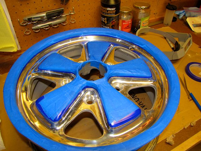

I just picked up some Fuchs wheels that I'll be using with some Bridgestone Potenza 195/60R15 tires. I'll be painting the centers black.
To paint the centers black I built a tool to cut the tape at a constant distance from the rim outer surface. It's basically a flat piece of aluminum with a standoff and a razor blade attached to the end. After taping up the wheel I just sliced thru the tape with the razor blade tool and had a perfect tape line. I'll add some pictures of the finished wheel next.

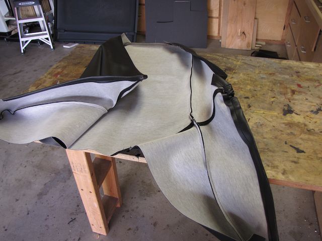

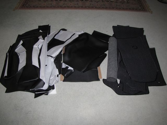

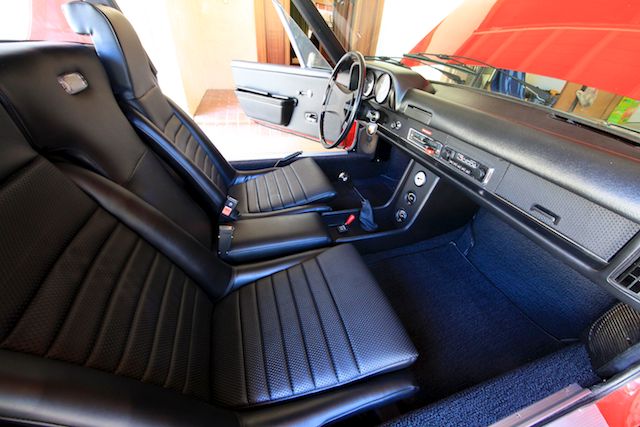

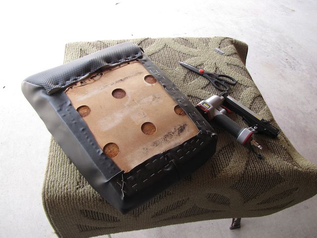

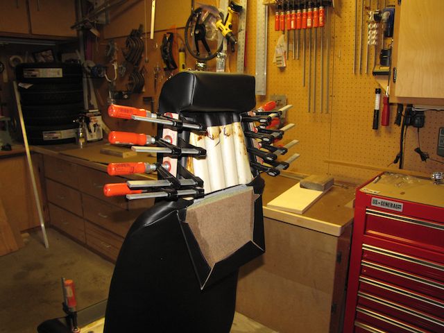

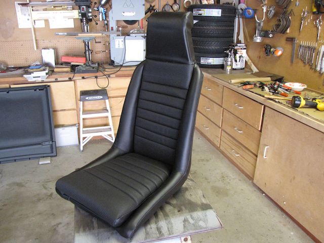

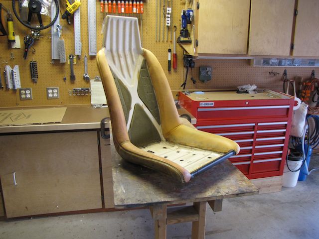

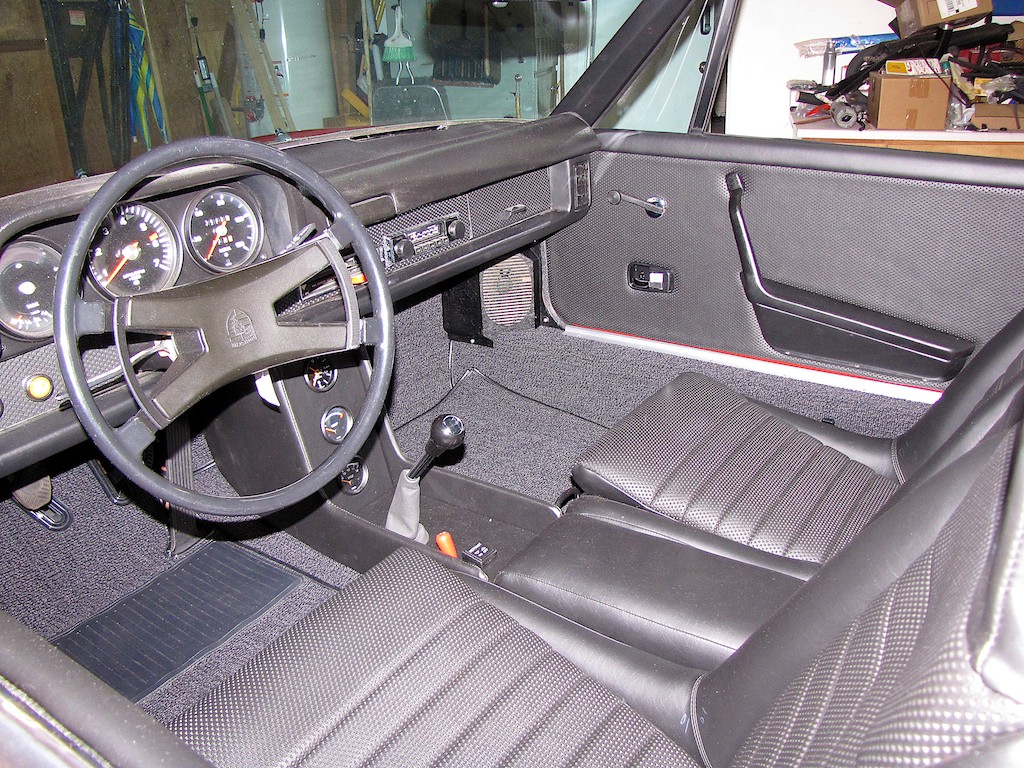

Started working on the interior this week. I bought a complete interior kit from Autos International and the quality is really nice. The kit was $1400. which included the seats, door panels, back pad, carpet and headliner.
Attached Image Attached Image Attached Image Attached Image Attached Image Attached Image Attached Image Attached Image Attached Image

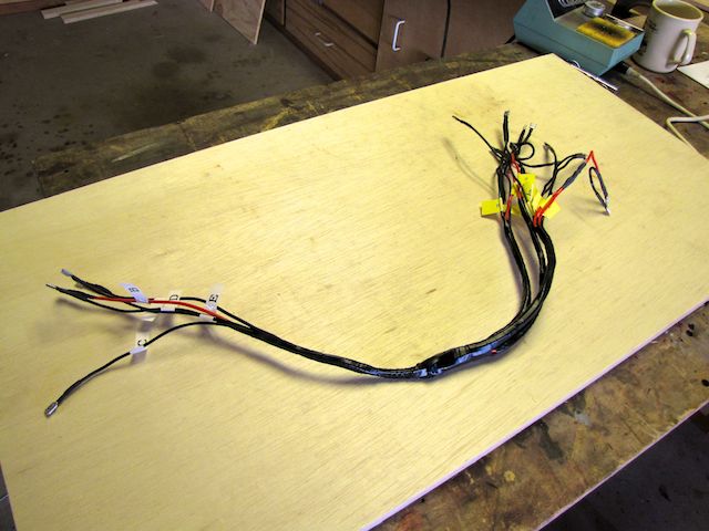

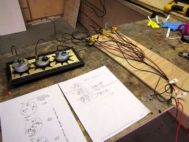

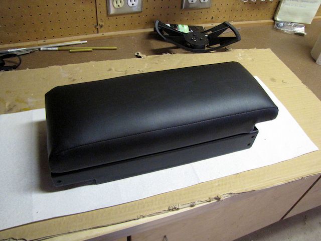

The next project was to make a wire harness for the gauges in the center console.

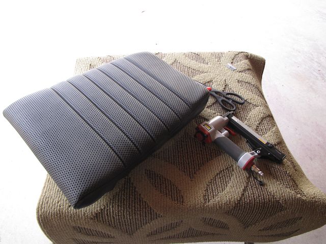

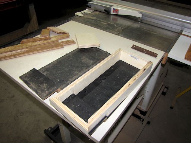

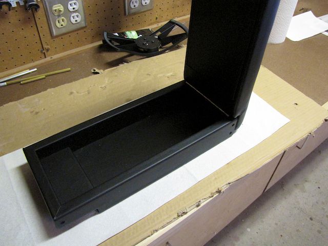

My other hobby is woodworking so I couldn't resist making a new center arm rest box.
The car didn't originally have one so i got one on ebay to use as a template.

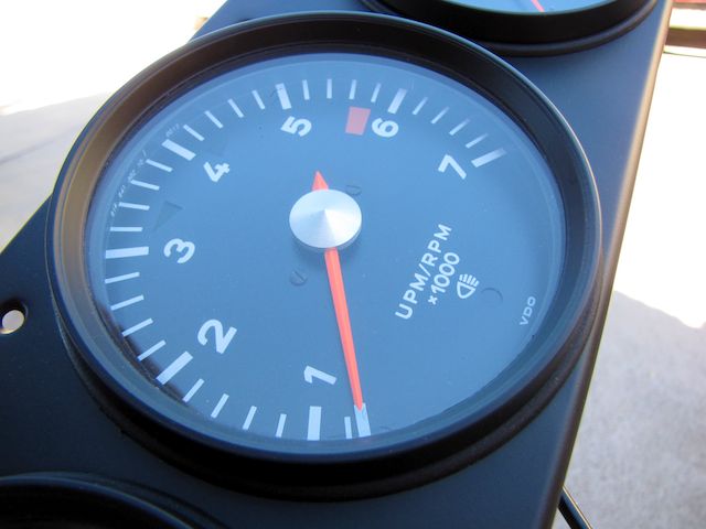

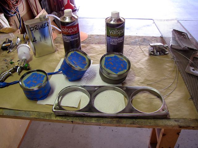

The gauges were in bad shape so I sanded them down and painted them with the same semi gloss paint I used for the valances.
