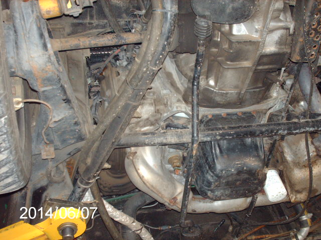

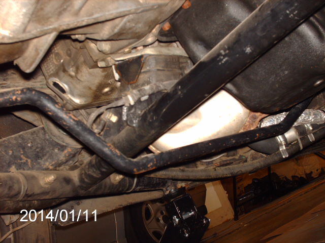

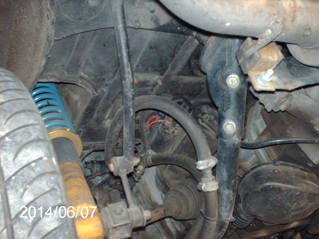

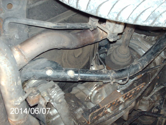

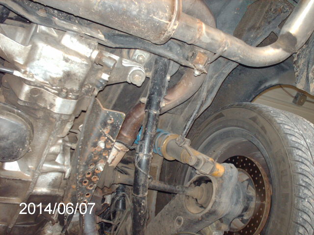

Anyone have a install picture of the Boxster S, on how it is mounted in the rear?
Also wondering after getting it up on the hoist today, if a person couldn't adapt part of the Subie framework, and LS motor mount, and combine them, and would also aid in stiffening it up?
