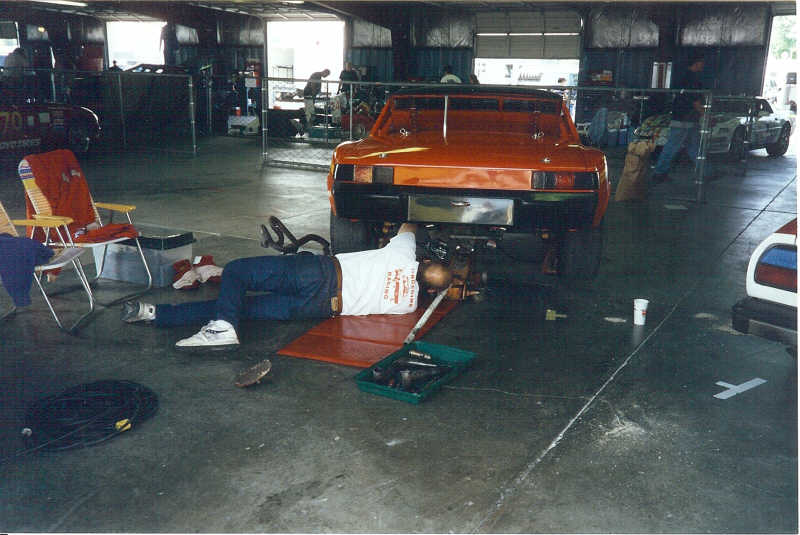

This was my first time at the track with a completely new oiling system in 1997.
We drove 7 hours so I could hang out under the car all weekend. (IMG:style_emoticons/default/headbang.gif)
At least I had the sense to rent garage space in advance, so it wasn't unpleasant, just discouraging.
