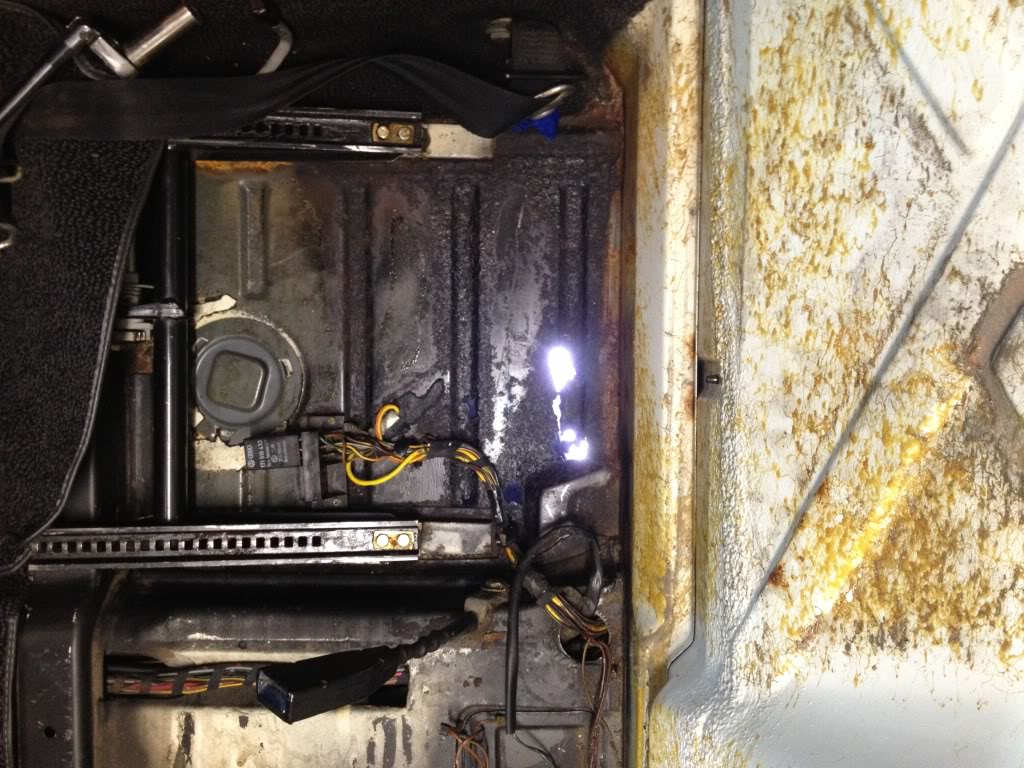

I pulled up the carpeting everywhere, and don't see any sign of rust anywhere on the floorboards. Battery tray has minor surface rust on a very small area. I'll hit that with some naval jelly, wire brush, and Rustoleum in the very near future.
I hate to come back to this point, please don't take it personally! (IMG:style_emoticons/default/biggrin.gif)
A visual inspection under the carpets is *useless* since the floorboards are covered with a thick layer of tar and the factory painted OVER the tar.
The floors will look rust free and perfect until the day the seats fall through.
You really need to take the time and do the crunch test and poke around with a screwdriver, especially behind the seats.
Many a 914 has had a leaking rear window at some point in its life, and that's where the water goes.
(IMG:style_emoticons/default/smash.gif)
Agreed. This is what usually happens due to a leaky rear window seal. This was a fairly rust free car. With the seats removed, it looked fine...until the tar was removed.
(IMG:http://www.914world.com/bbs2/uploads_offsite/i171.photobucket.com-8357-1402601930.1.jpg)
