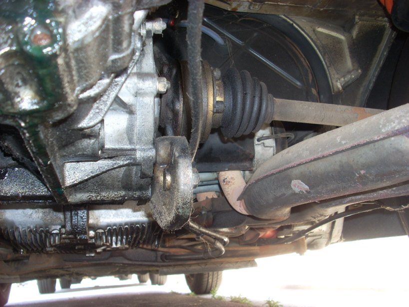

Pic showing the leaks:

Sleepin   Looks like it is a speedo drive o-ring leaking...n...   Jun 14 2014, 11:34 AM
Cuda911   ^^^ Ah, that makes sense... seller said something ...   Jun 15 2014, 01:57 AM
