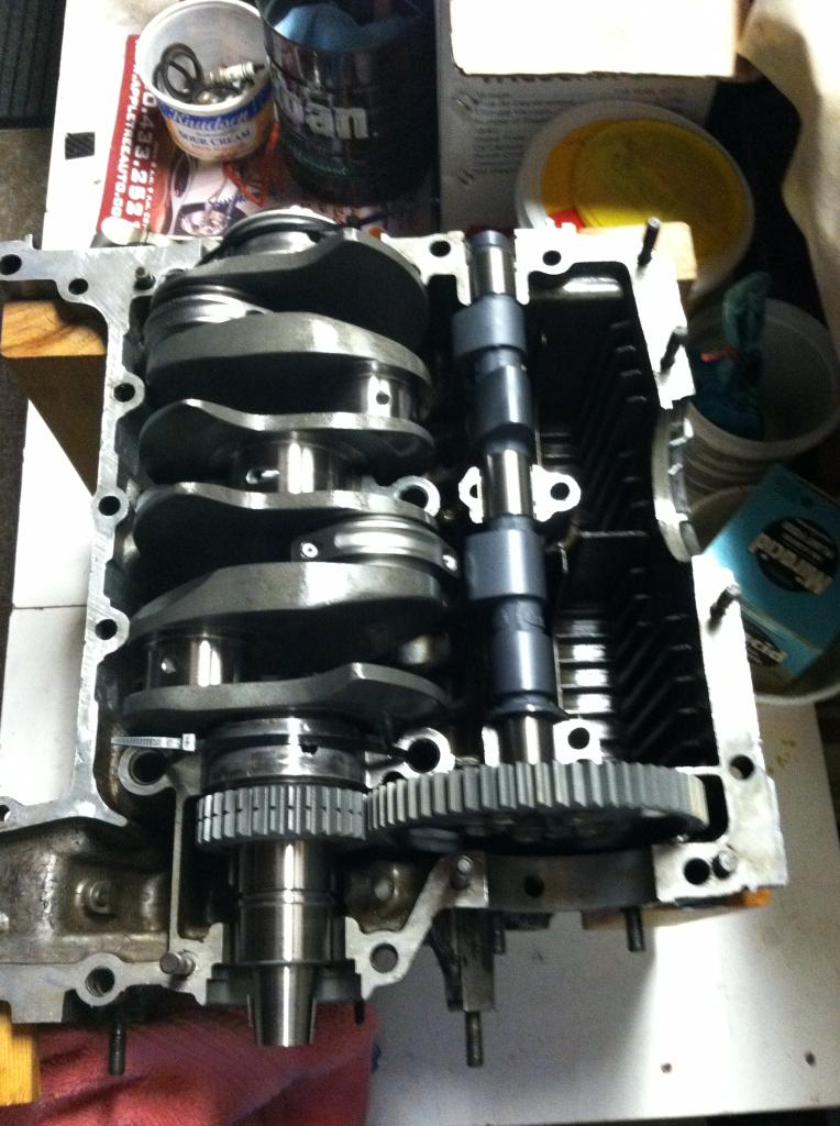

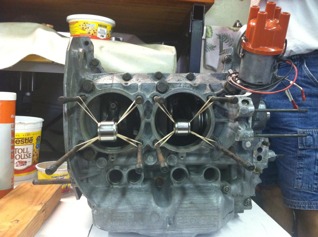

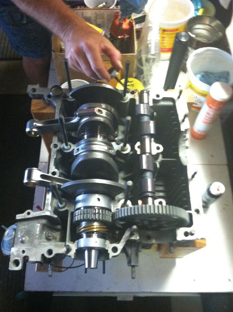

So since my last update i decided to ditch the stock rods because clearing the case with these and my +7mm of stroke was not happening.
Because of that I had to buy different pistons, as the pins are a different size.
Of course that means I bought bigger pistons, I bumped it 2mm Any larger and i felt like it would be getting out of hand.
Like the RMW stroker motors most of the power gain and drivable power comes from the additional stroke not the bore size increase,
While I could build this out to a even 3L i stuck with a 96mm x 78mm Stock bore was 94mm and stock stroke was a paltry 71.
Meaning my displacement went from 1971cc to 2258cc. I also added a much bigger and nasty Web Cam ( gotta be careful googling that)

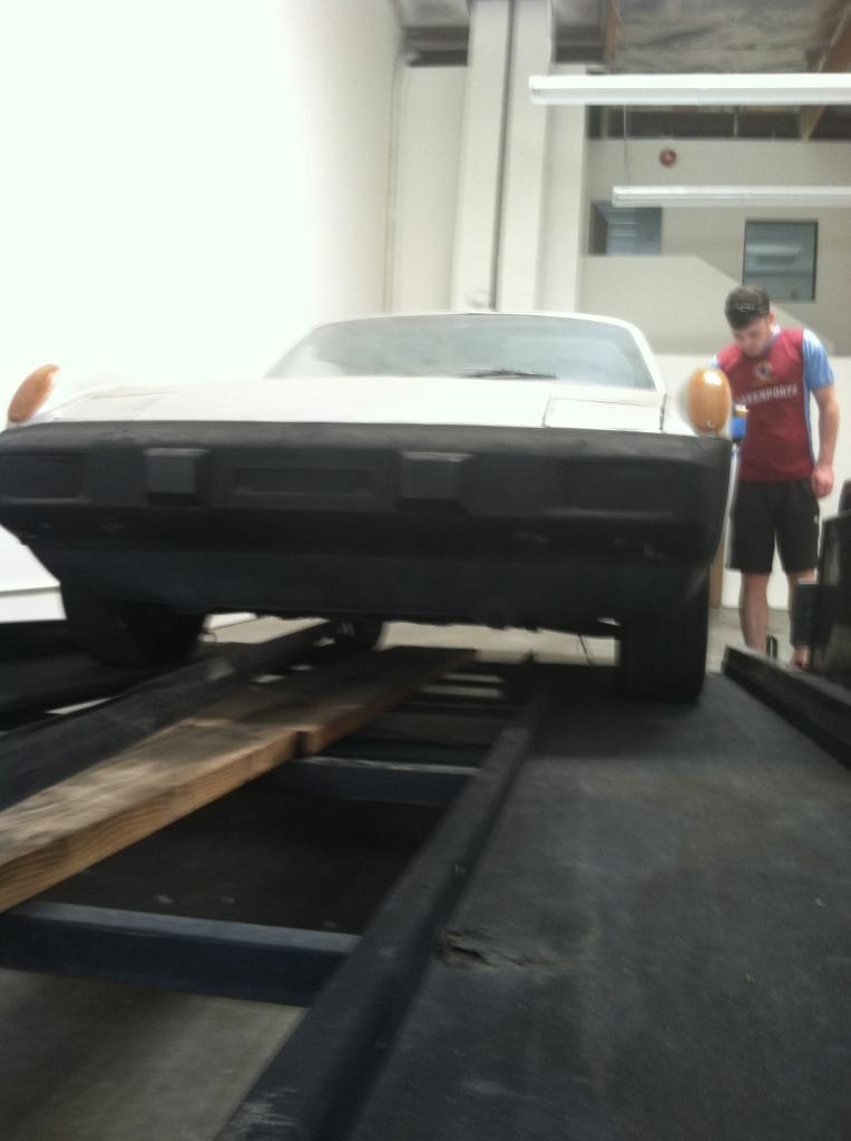

Since had to move the car from its first parking place to another because reasons.

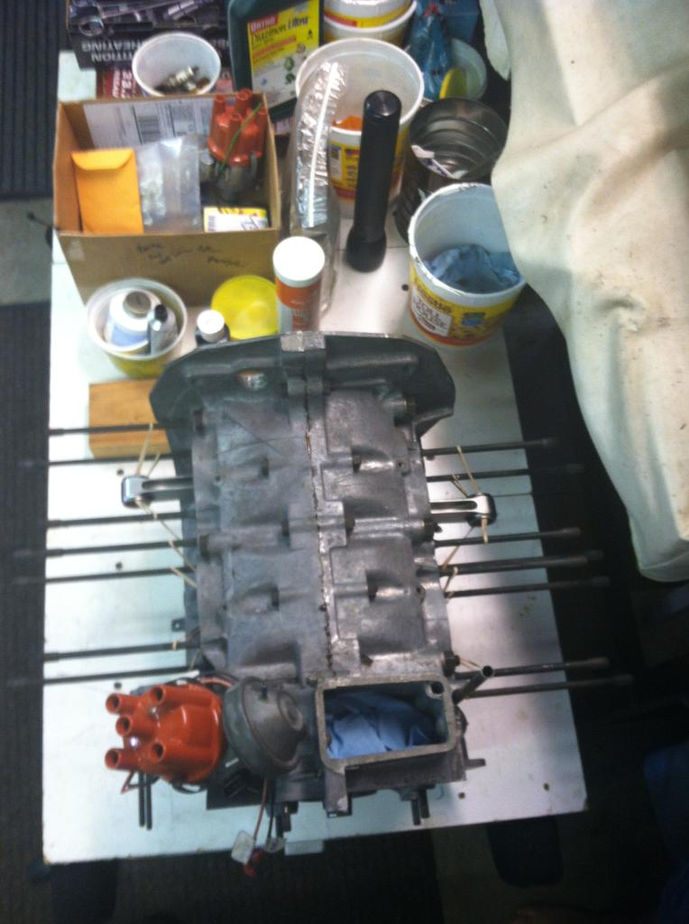

And now the pictures. Re assembly has begun, got the case sealed together tonight so next up is Pistons and cyls then heads.
Sticking with stock heads for now, because of two reasons. Money and really they flow pretty damn good stock. my friend flowed my spare set....
