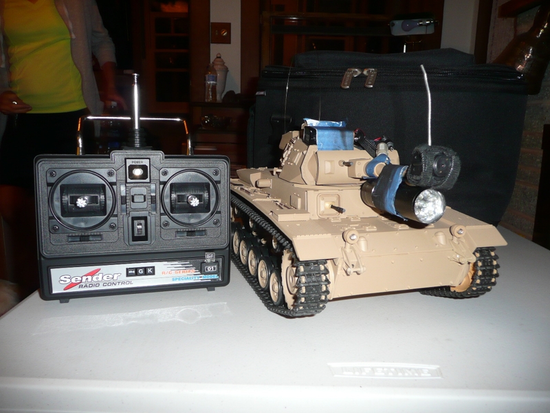

I need to convince the 'Minister of Homeland Renovations' that I need a two-week break (IMG:style_emoticons/default/dry.gif)
We're getting ready to have our house fumigated (it's been 12 years since it was done last) ... problem is, one of Pepé Le Pew's cousins took up residence under the house sometime during the past couple of weeks (IMG:style_emoticons/default/sad.gif)
I set up some wireless cameras and finally spotted the critter leaving (just past midnight), so I secured the point of entry (unfortunately, AFTER it left a blast of what smelled like some potent skunkweed under the house). Being springtime, we're not sure if it has some youngin's living down there too (IMG:style_emoticons/default/sad.gif)
So, with time being of the essence, I got me an RC tank and outfitted it with some recon equipment today (LED lighting and a wireless camera)... I'll be deploying it under the house to asses the situation tomorrow.
Yeah, it's not a 914 ... but it is a German Panzer (IMG:style_emoticons/default/laugh.gif)
